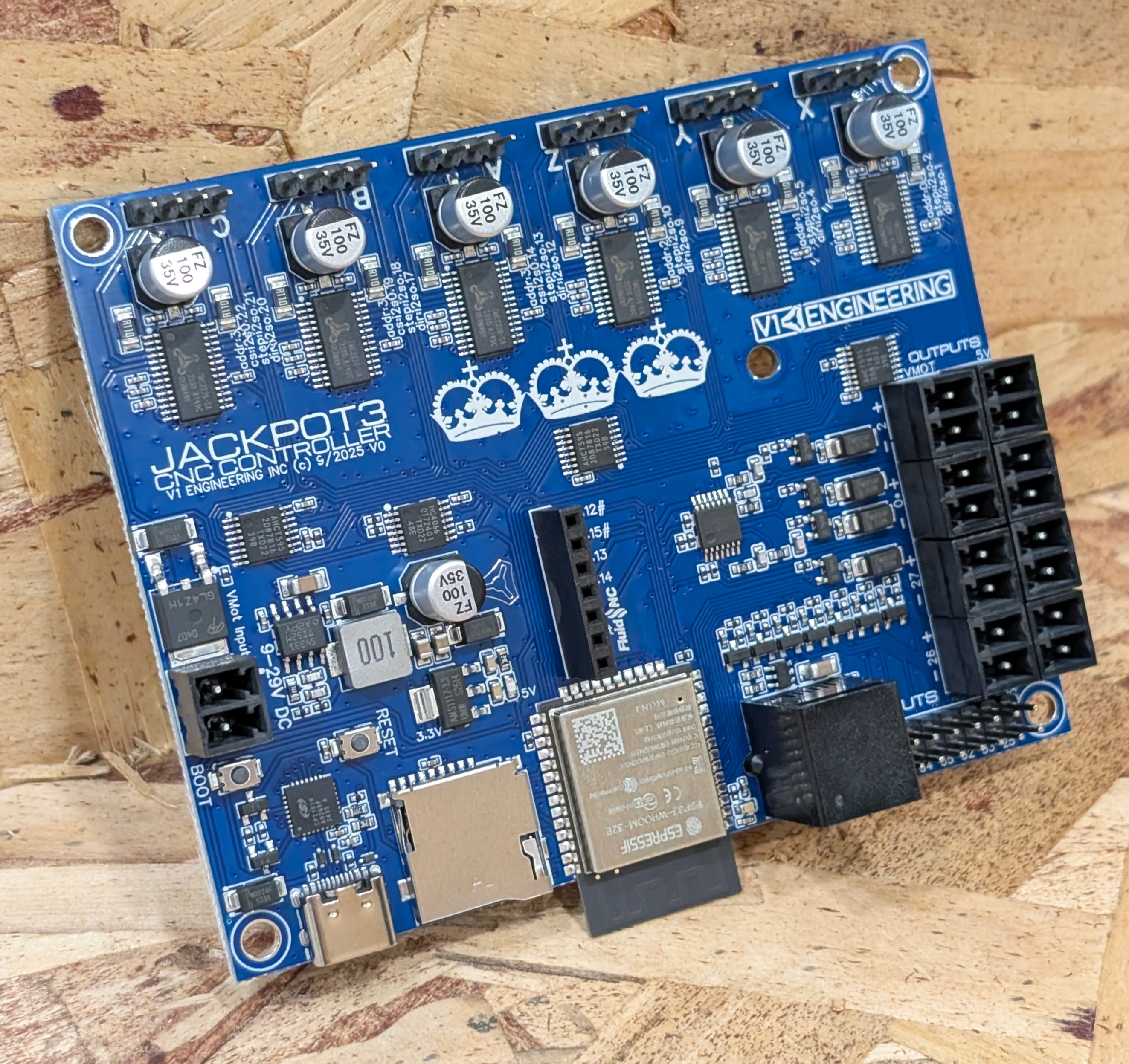

The Jackpot3 CNC Controller is an all in one CNC control board. This board allows you to wire up your Nema17 (or smaller) based CNC machine with nearly any peripherals and control it wirelessly with nearly any web enabled device.
!Jackpot CNC controller
Highlights
  • 32bit dual-core 240mhz control board
  • Built in wireless control software, Wi-Fi (802.11b/g/n), Bluetooth LE (BLE), or hardwired capable.
  • 6x TMC2226 drivers (nearly identical to the 22209 with better heat transfer)

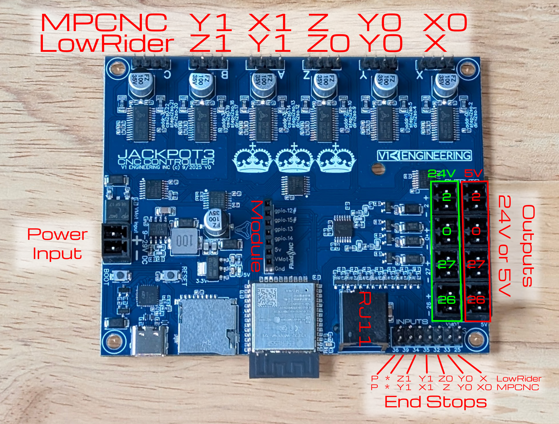

  • 6x Integrated Stepper drivers
    • TMC2226 drivers in UART control mode only
    • The sockets are labeled XYZABC, but you can use any socket for any axis or motor number. The letters are for reference only.
    • No Stallguard
    • Digital current control, no tiny potentiometers
  • 7x Inputs
    • 3.3v-5V tolerant as of the first revision labeled “V1” when More robust ESD protection was added.
    • All switch inputs are active low.
    • inputs have a 10k pullup external to the ESP32. The signal pin (S) should be connected to the ground pin (G) to activate the switch.
    • The input pins can be pins in the config file to use Normally Open or Normally Closed inputs.
  • 4x 5V or 24V Outputs
    • Can be used to drive 1A continuously. You can use them intermittently up to 2.5A.
    • They can be used with inductive loads (solenoids, relays, DC fans/motors)
    • See the “Spindle” section of the FluidNC wiki for common uses
    • Full PWM on the 5v port, basic/slow PWM only on the 24V port.

Wiring
Click on the image to enlarge it.
!Jackpot2 CNC LR pins

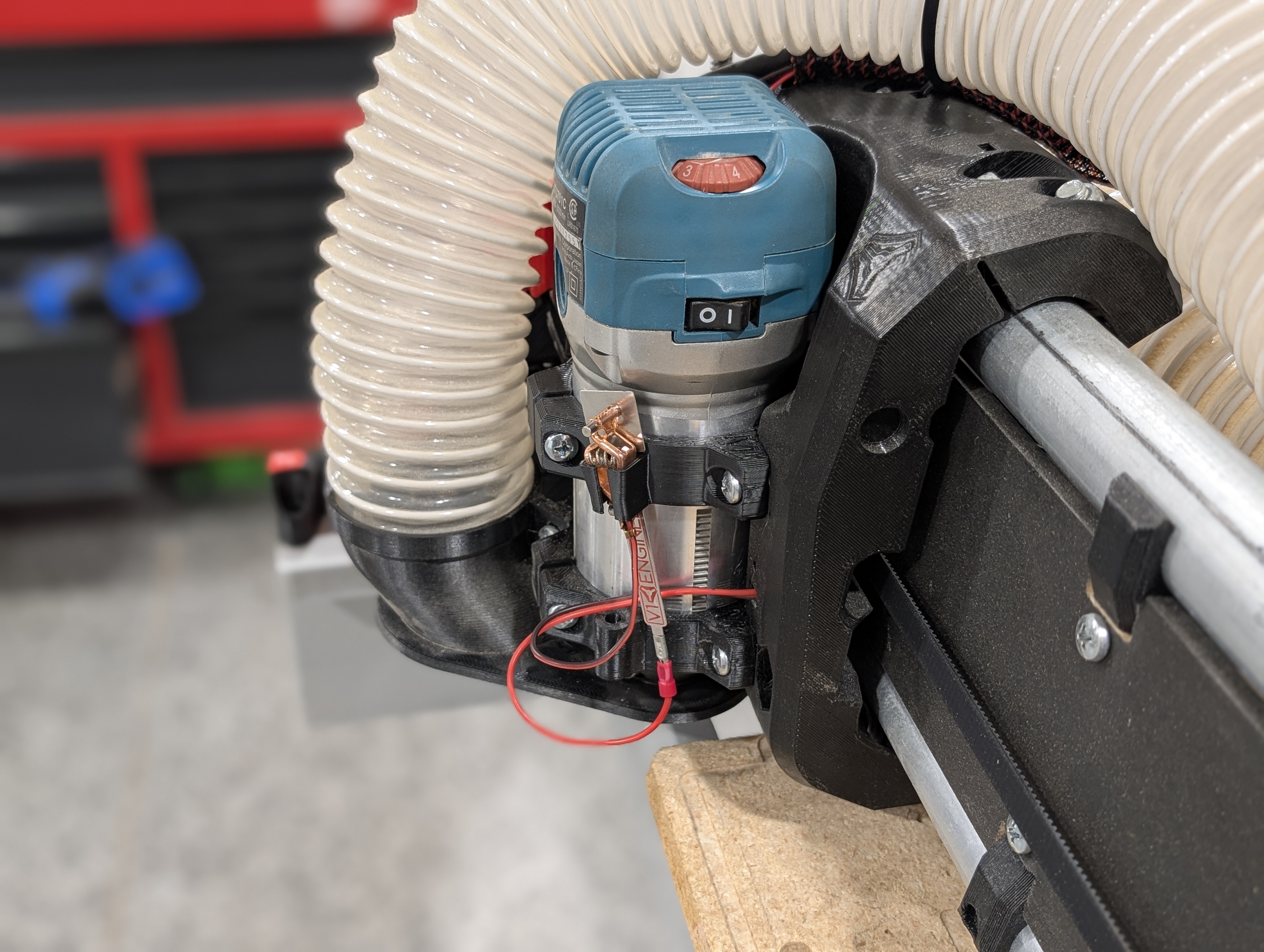

Cooling fans are typically hardwired to the power input, always on
The probe/touchplate plugs into the last port (gpio.36), on either configuration.
Case Fans, if you choose to use a case fan to cool your drivers you will typically wire the fan directly into the Jackpot3 main power so when the board is energized so is the fan. This means you need to get a fan that uses the same voltage as your power supply. We use a 24V power supply in the kit and sell a 24V fan in the shop.

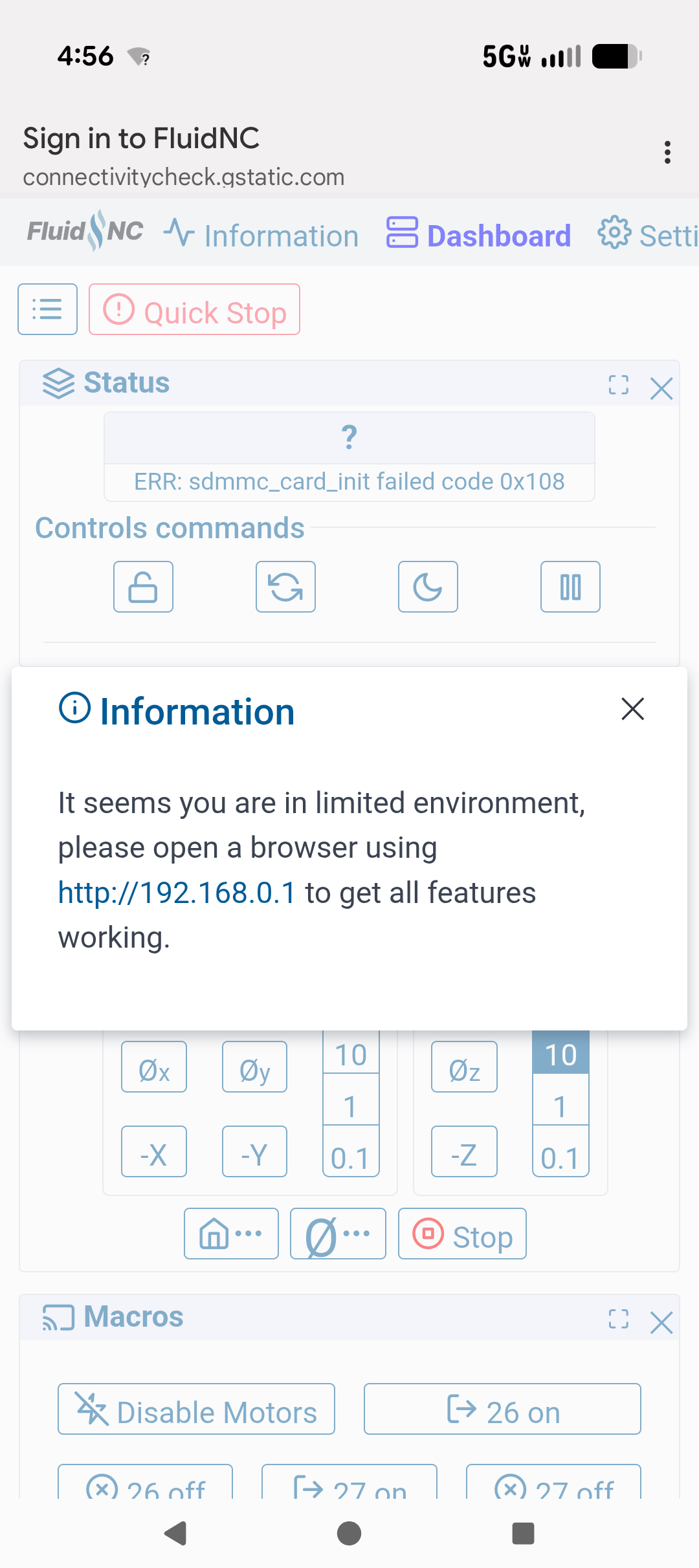

!Jackpot3 SSID

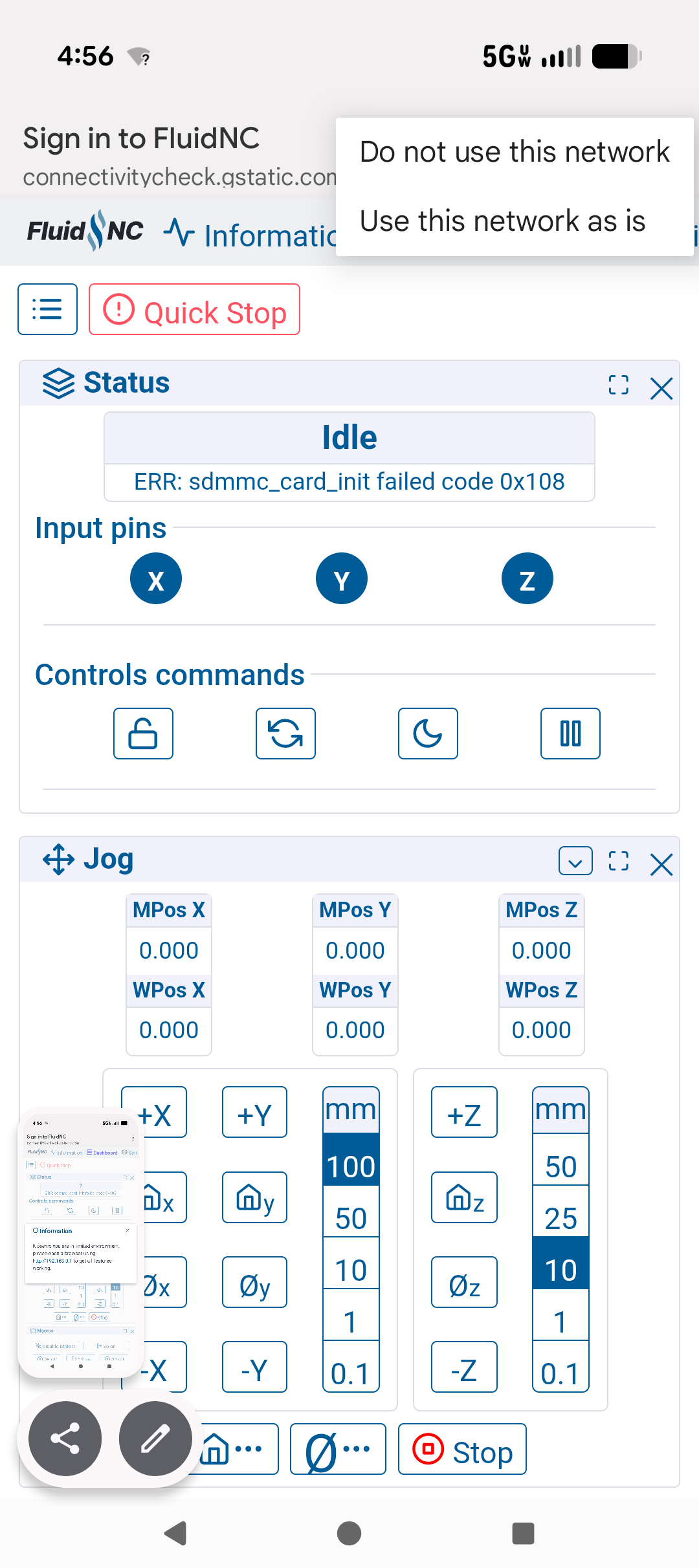

If you bought your Jackpot3 CNC Controller from the V1E.com store it should be ready to go. You should be able to log in directly to the WiFi SSID “FluidNC” and the password = 12345678
Most browsers will then need to be told to “use this network as is” (upper right corner menu) and then navigate to http://192.168.0.1, best to bookmark that address.
Mobile devices will need to click somewhere up in the top right corner, the “hamburger menu”, click “use this network as is”, the browser window will usually close at that point. Then navigate to http://192.168.0.1, best to bookmark that address. Here is a short video showing what that looks like, YouTube
!Jackpot3 log in
On a desktop browser just click the pop up link to open the full UI in a new tab.
!Jackpot3 log in
!WebUI
This Interface is from the ESP3D V3 WebUI project. This interface allows for wireless machine jogging, custom macros, quick buttons for any of the Jackpot3’s outputs, terminal control, file system control, UI and board configs, all in one place. You can update the firmware, GUI, and board settings all from the WebUI.You can wirelessly transfer your gcode files, but manually using the MicroSD card is still preferred. This can be used from most any device that has a web browser. If you are using a small touchscreen you can even zoom in so the buttons are easier to hit.

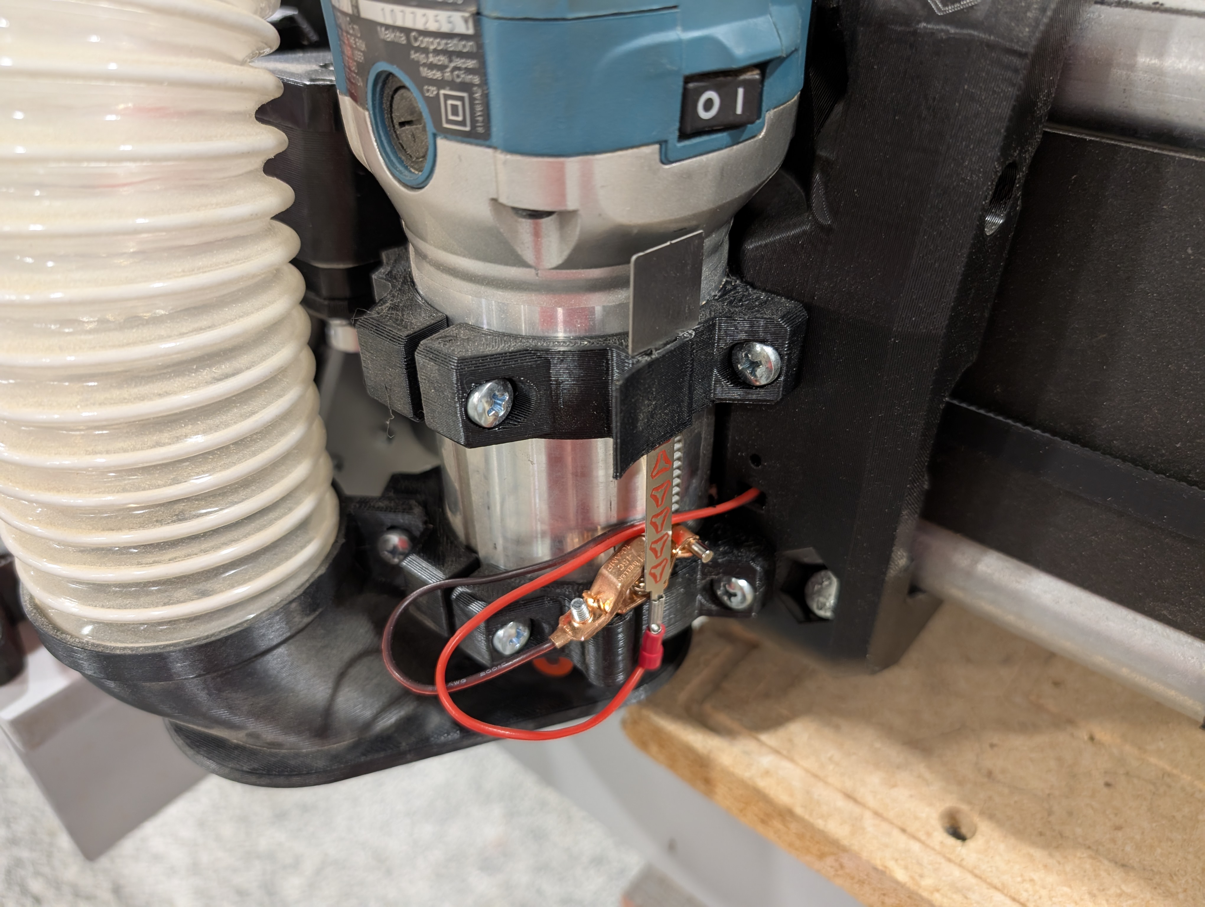

The Z probe should be wired with the spindle side (clamp / magnet) to the ground side of the plug and the plate to the signal side. To be as safe as possible the probe and clamp should be stored touching to dissipate and static and keep the board’s inputs safe. A good habit is to touch a ground before reaching in to grab the touchplate.
!touchplate
!touchplate old style

Jackpot3 versus Jackpot
Over all the Jackpot3 (JP3) just takes what we learned from the original Jackpot (JP) CNC Controller and made a few small quality of life and functionality improvements. For most there is no compelling reason to change from a Jackpot 1 to a Jackpot3, but going forward the Jackpot3 is a better value.
Drivers
JP3 - All 6 populated and integrated same functionality better heat transfer, three large thermal layers per driver.
JP - Swappable drivers.
Outputs
JP3 - All 4 dedicated outputs are voltage selectable (input or 5V), easy to use plugs.
JP - 2 “high” voltage, 2 5V ports only.
RJ11 for pendant or airedale
JP3 - Included protected input RJ11 uses 2 module pins, lets you use 2 pin on a module and the RJ11 socket at the same time or all 4 module pins and no RJ11.
JP - Add on card required, uses all four module pins.
USB
JP3 - Uses USB-C.
JP - Micro USB (delicate), most usb-c esp32 were poor quality.
Power
JP3 - New plug/socket, reverse polarity protection.
JP - Screw terminals that had over tightening issues for some.
ESP32
JP3 - Integrated esp32 for better heat transfer, overhanging antenna for better signal, USB only breakout pins.
JP - People tended to bury the antenna under their wires for a poor signal, swappable.
Stepper Plugs
JP3 - Open 2.54 male headers for ease of use, fits more plugs without modification.
JP - Caged headers are secure but did not fit all plugs.
