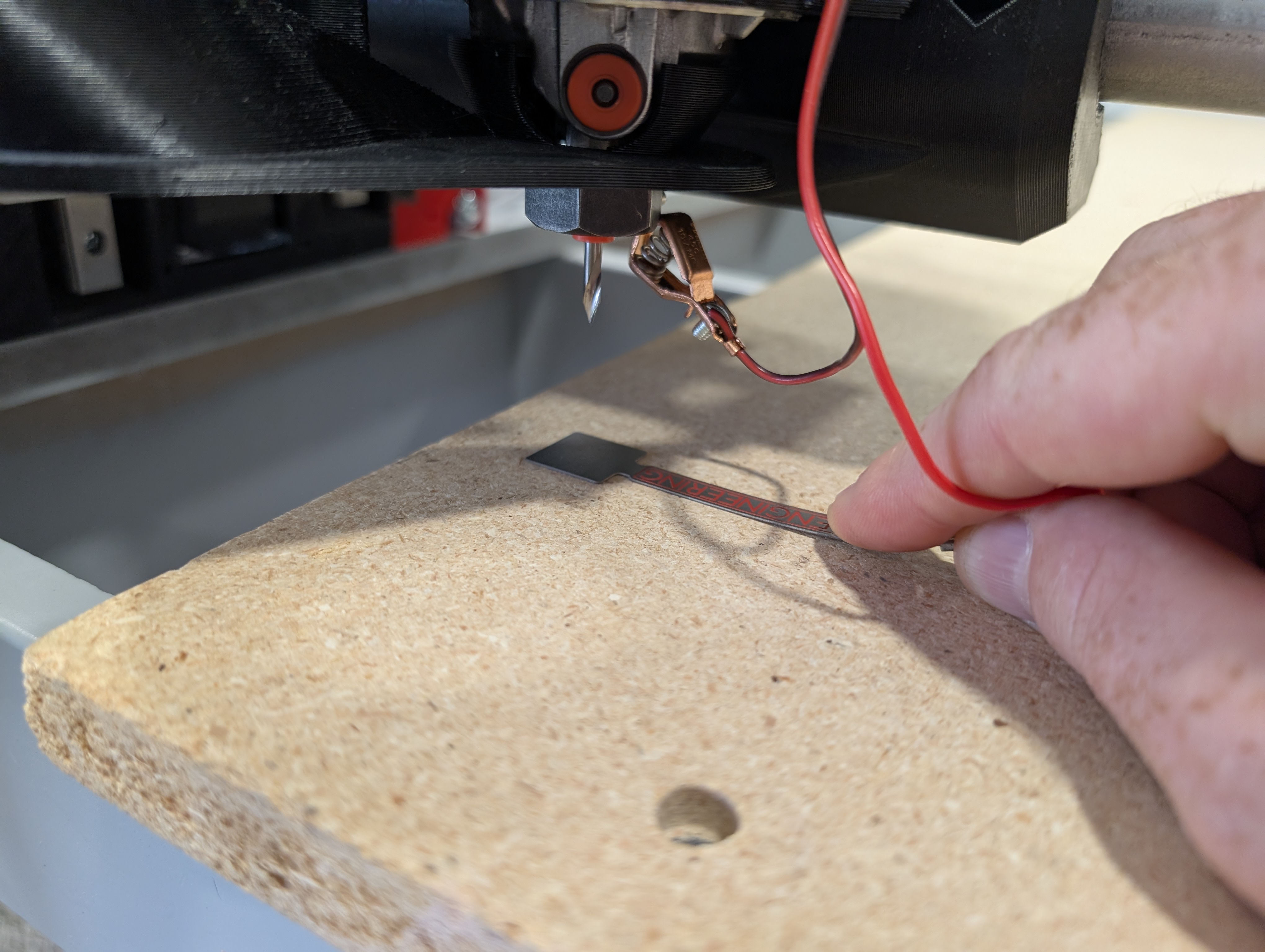

  • Full Y axis squaring, Z axis leveling, and Z probing are standard for excellent precision and accuracy.

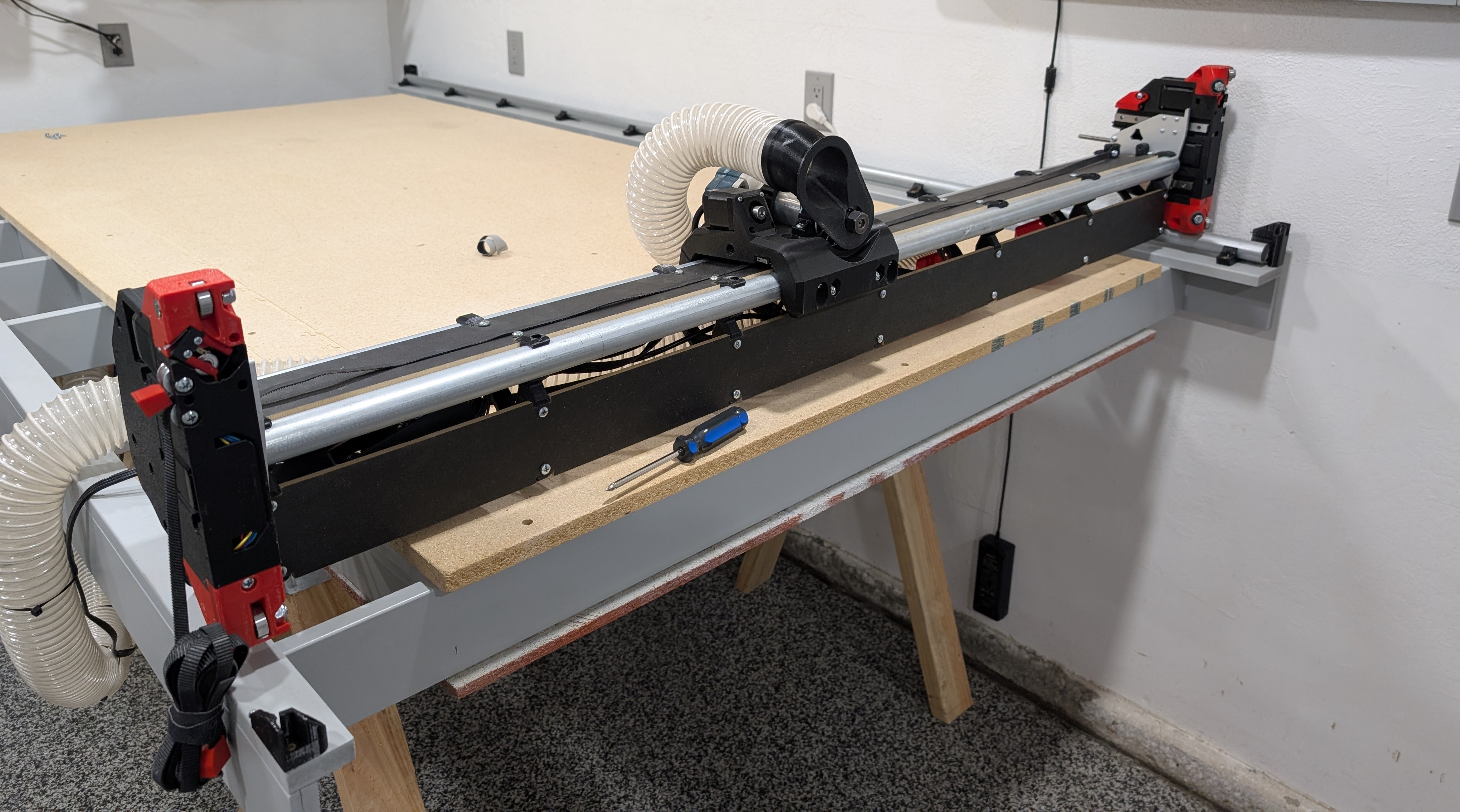

!LR4 Core Picture
Size and Shape

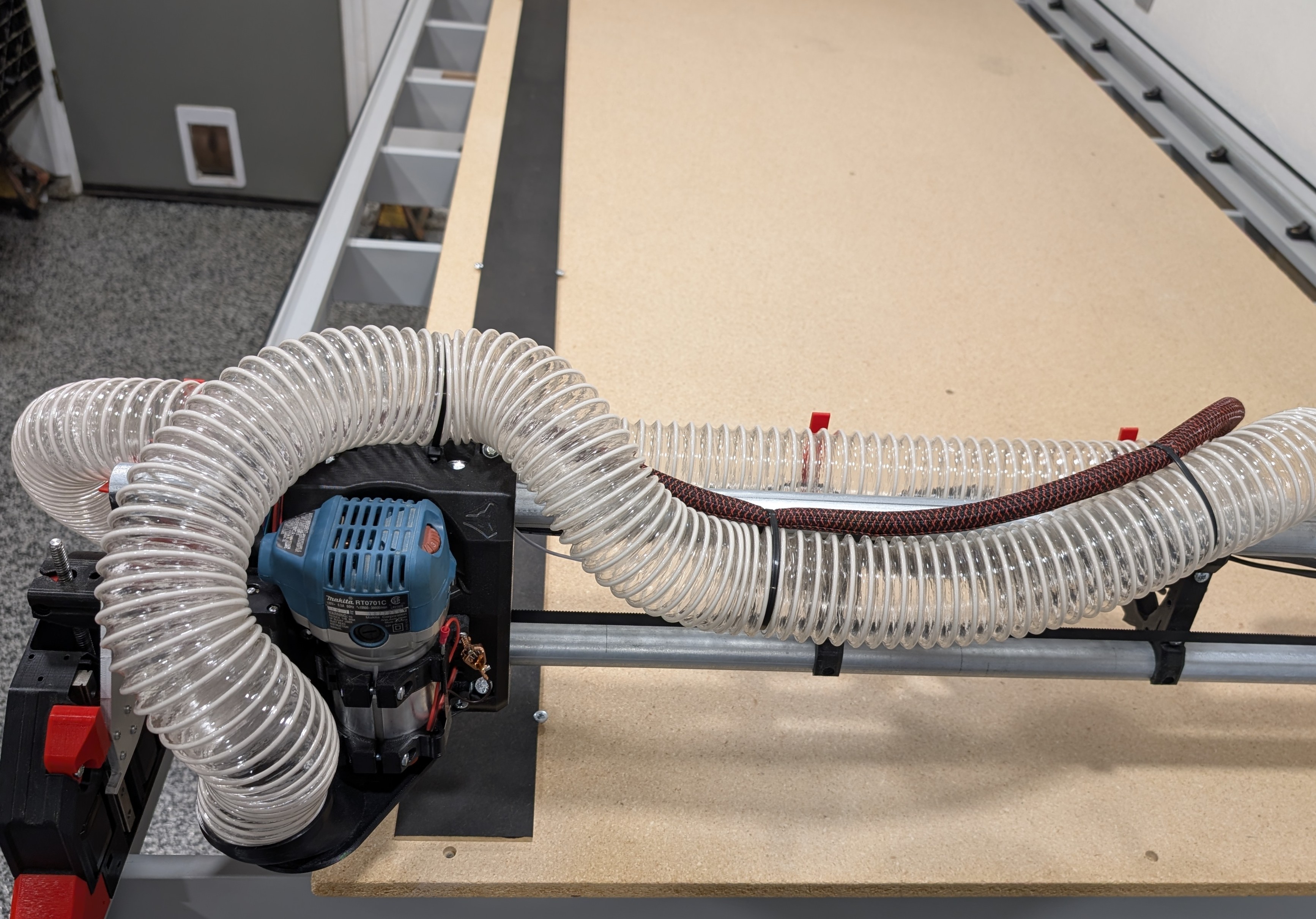

  • A typical build has a working volume of full sheet, ½ sheet, or quarter sheet. In the US that would be 8’x4’, 4’x4’, 4’x2’
  • A standard build would give you 50mm of Z cutting depth, or you can use a drop table to use all 100mm.
  • The CNC router can technically handle even larger sizes, but the smaller the build, the faster it can cut.

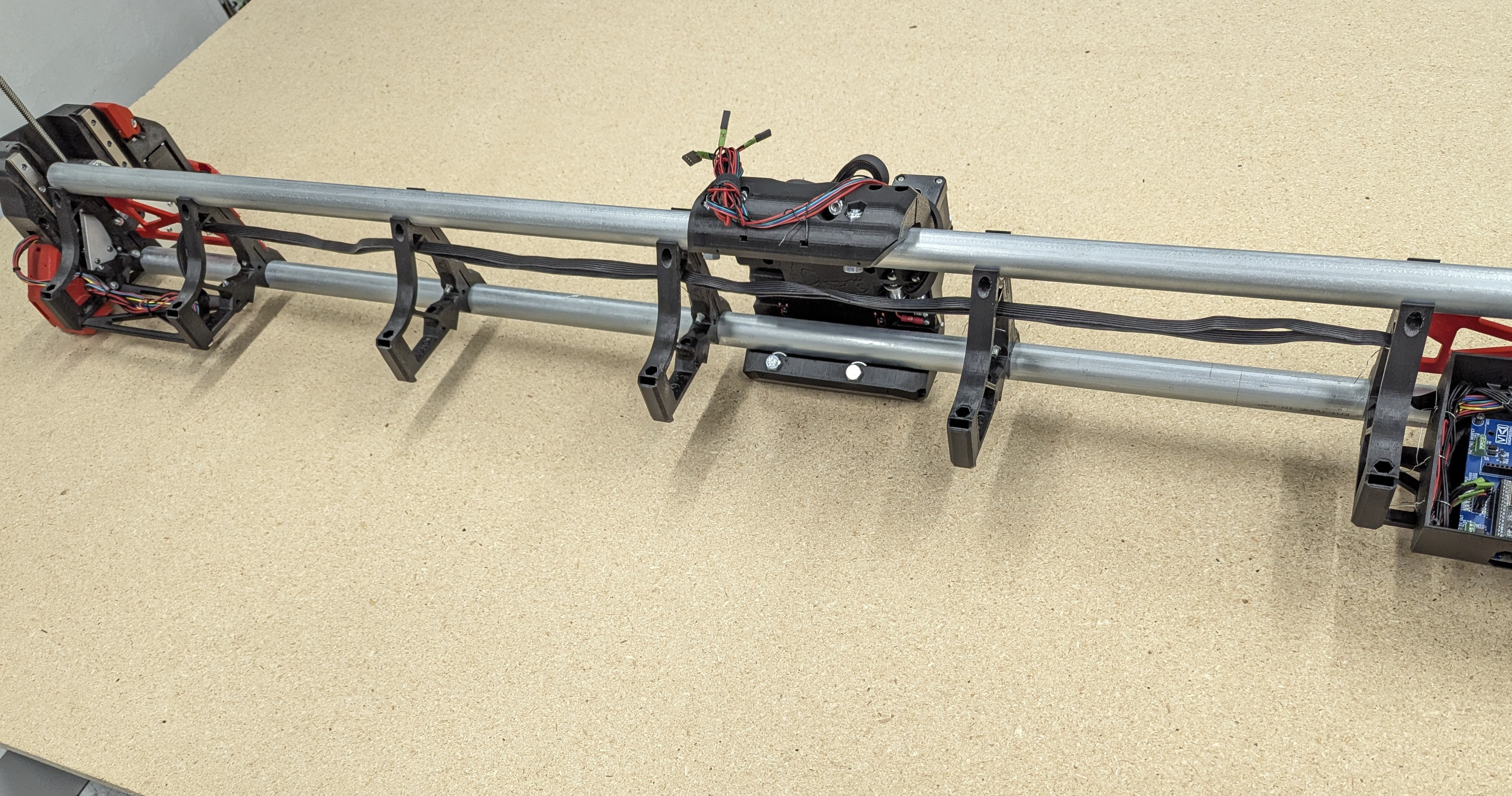

  • The single Y rail keeps the machine properly constrained while maintaining ease of use.
  • Two rails are extremely difficult to align. We made it so you don’t have to mess with that.
  • Width (X axis or “Beam”) should always be the shorter axis.
  • This CNC router is most rigid when working near the table surface, opposite of most conventional gantry CNC machines. So as your cut progresses (the lower you go), the machines rigidity increases.

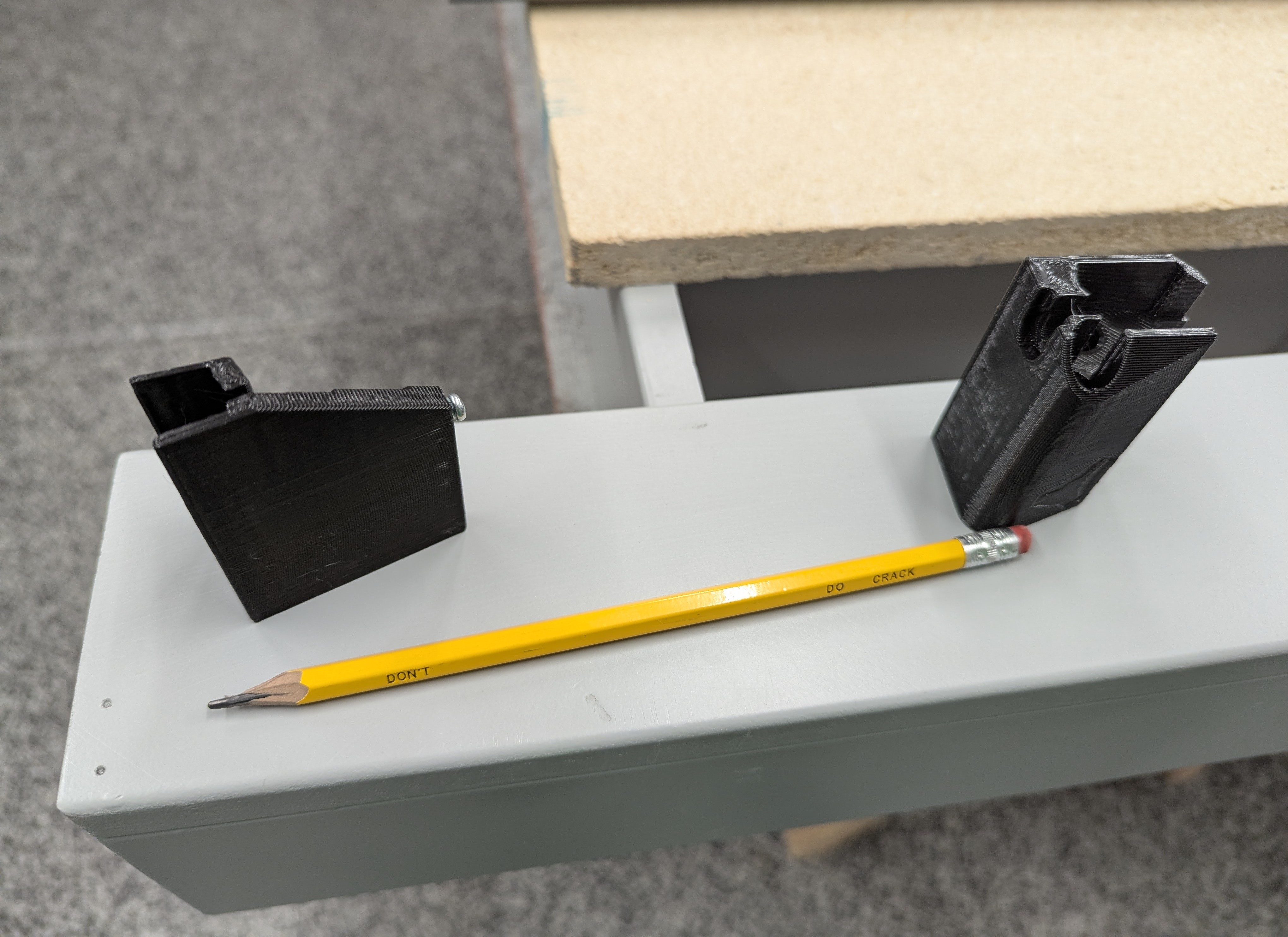

  • Do not use supports, keep the default orientation.
  • You will need about 2.7kg of filament for a full set with tool mount and a board box.
  • PLA is recommended for ultimate rigidity. Other filaments with great rigidity and added heat resistance are PET-GF/CF and PC-GF/CF.
  • 3 walls rectilinear or cubic infill for most parts. Thicker layers, since these are large parts, no more than 80% nozzle diameter to layer thickness ratio to keep steep walls working. For newbies: the printer files downloaded from the links above should have these settings by default, but its best to verify.
  • 200mmx200mmx190mm available build volume is needed to print these parts.

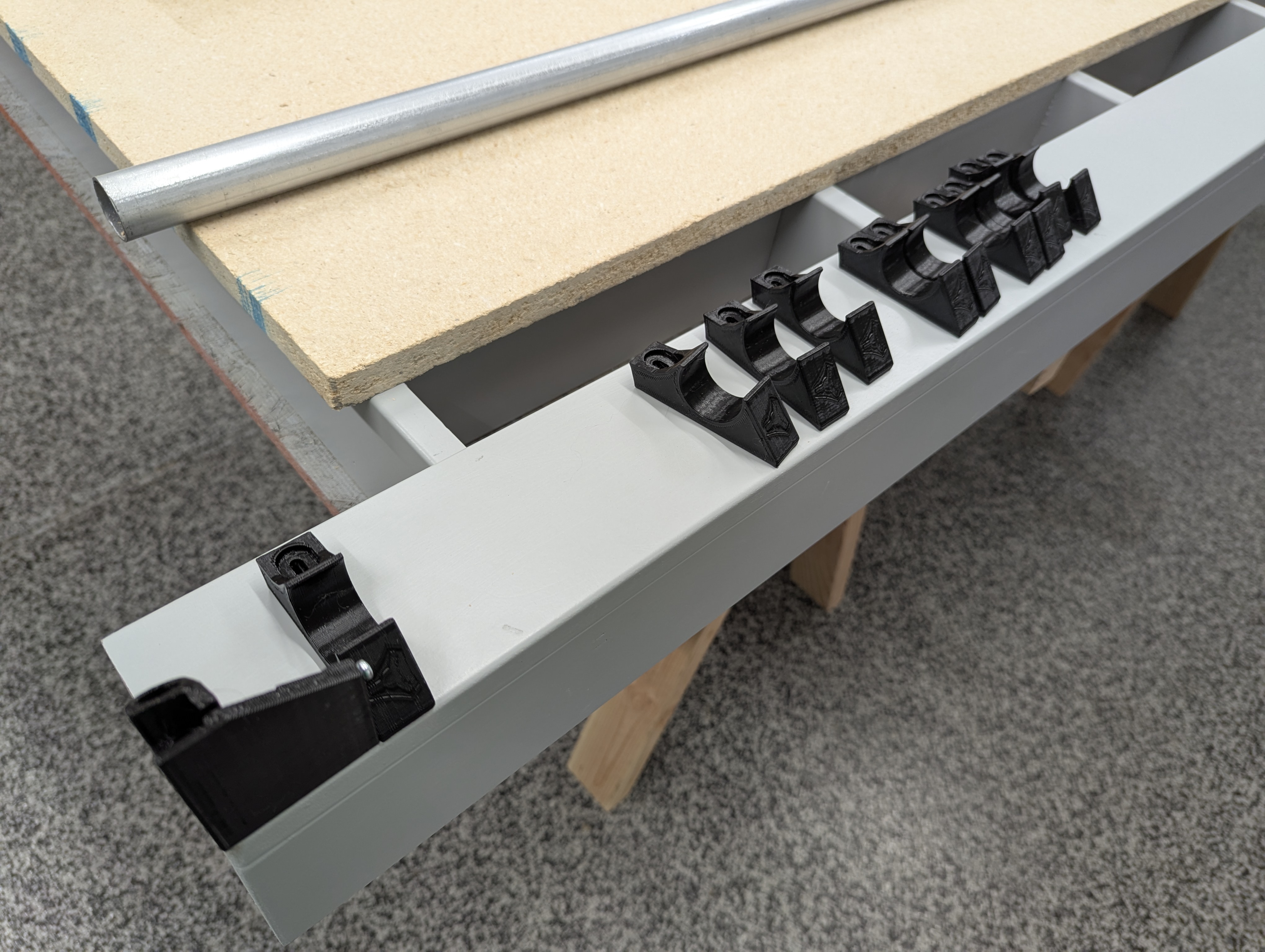

7-10 Y_Clip_### 30% No more than 300mm center to center

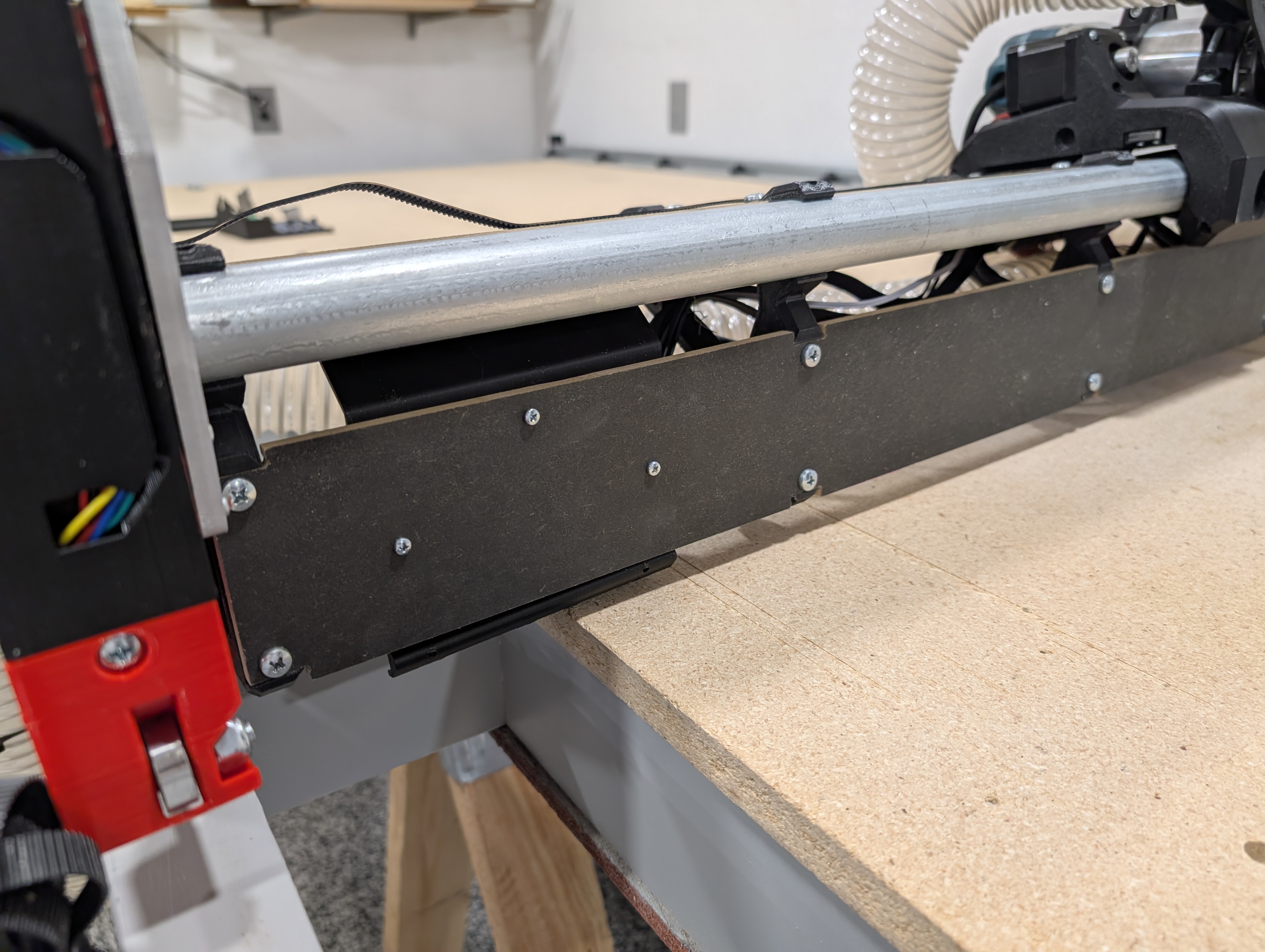

!LR4 JJ's Picture
Flat Parts
Strut Plates

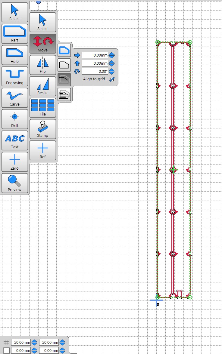

Strut plates give the X axis beam it’s rigidity. You are meant to assemble the machine using the printed temporary strut plates, and then use the machine to cut its own permanent strut plates.
  • You will need a rigid material 6.35mm (¼“) or thinner for your plates.
  • Common options include: MDF, hardboard, plastic, metal is a premium option and is not necessary.
Vector76 Strut Generator Jamie made this easy to use site so you can have any size plates you can dream of. The strut length comes from the calculator, but it will cut slightly smaller (0.5mm) by design.
  • strut_length = value from the calculator
  • num_braces = leave at default
  • size of dogbone... = leave at 3.5 for a ⅛” (3mm) endmill
  • Check both front_plate and bottom_plate
  • front_wing_size = 11.5 for 29.5 mm (1” EMT conduit), or your conduit size if different.
  • Click Render (Ctrl+Enter) to create your strut plates
  • Click the link to download strut_plate.svg. More on what to do with this later!
  • His site has all sorts of other helpful things linked on other Docs pages.

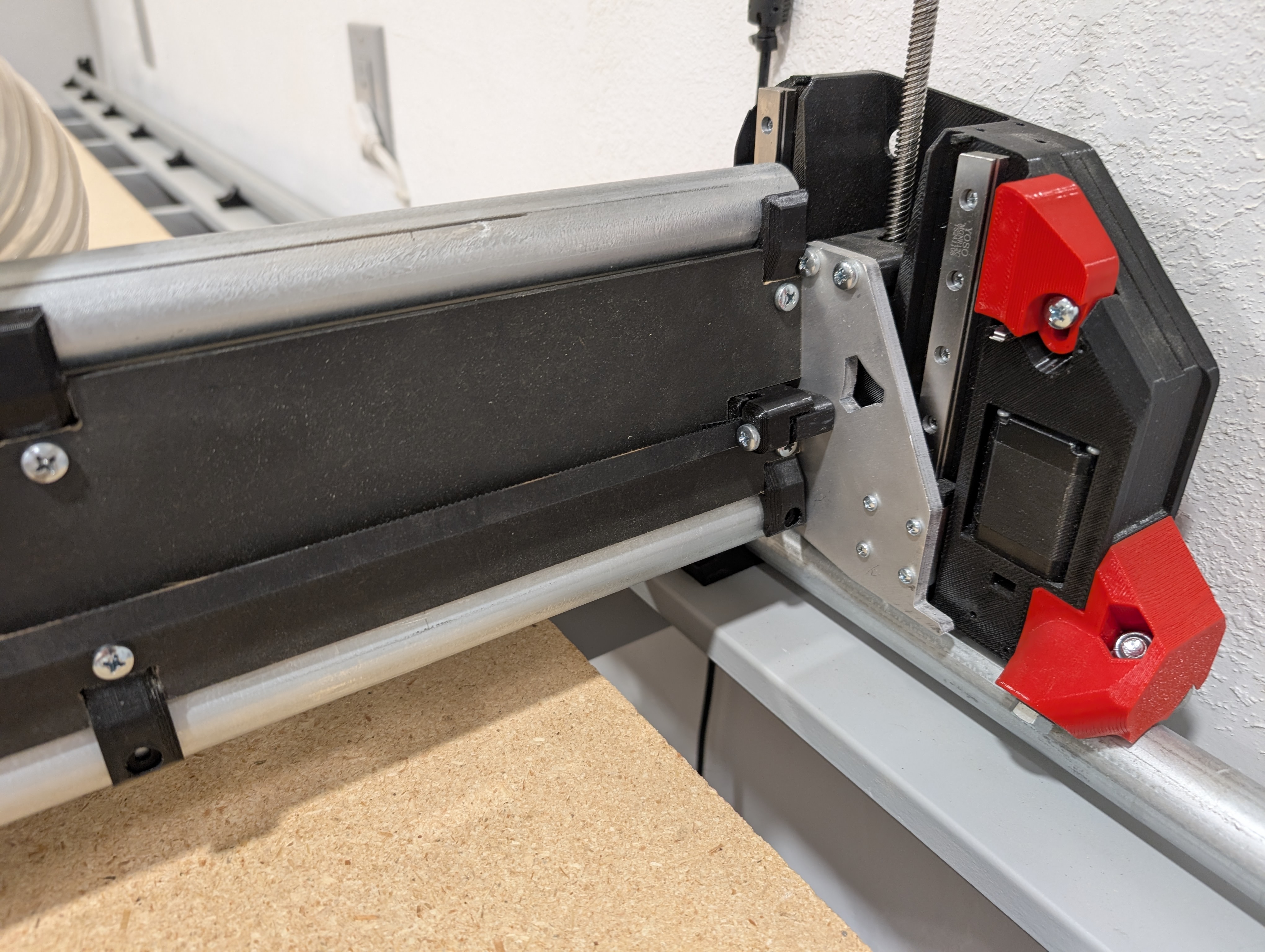

XZ Plates connect your X axis beam to your YZ plates.
The easiest option for most people, are the metal XZ plates from the V1E.com shop or, if you are in the EU, from HaWiWe.
Other options:
You can cut your own metal plates with the DXF files found with the printed parts files linked above. Aluminum or steel ¼” (6.35mm) thick material is suggested to work well with the hardware as is. If you want to use thicker or thinner material you will need to adjust the 16 M3x10mm screw length to compensate.
There is a file for printable XZ plates by member Aza, the idea being that you would only use them temporarily to cut metal plates. This is only recommended if you have experience with Aluminum cutting on a V1 CNC.

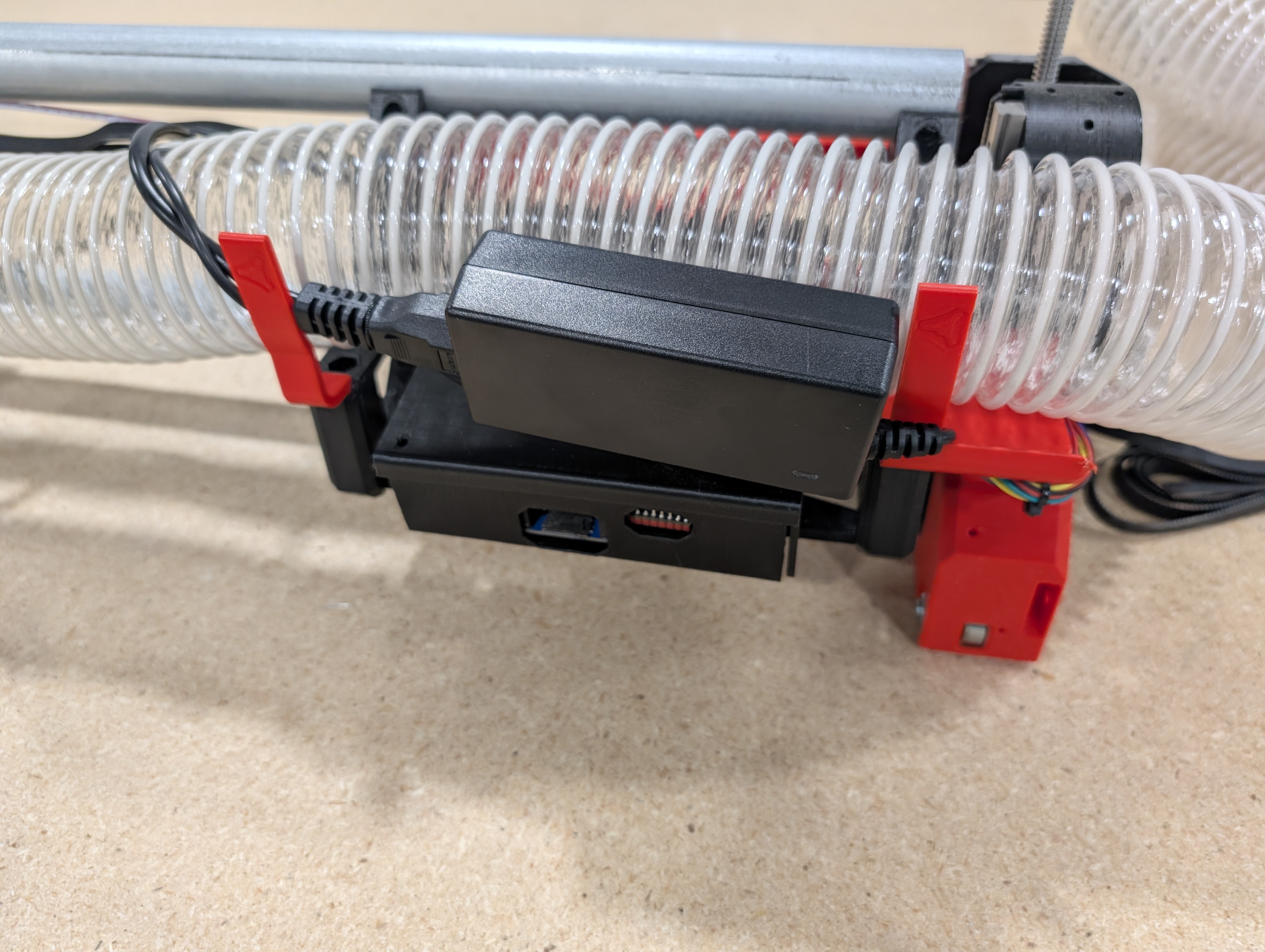

1 Power Supply 9-24V Board dependent 36W+ Shop – Amazon

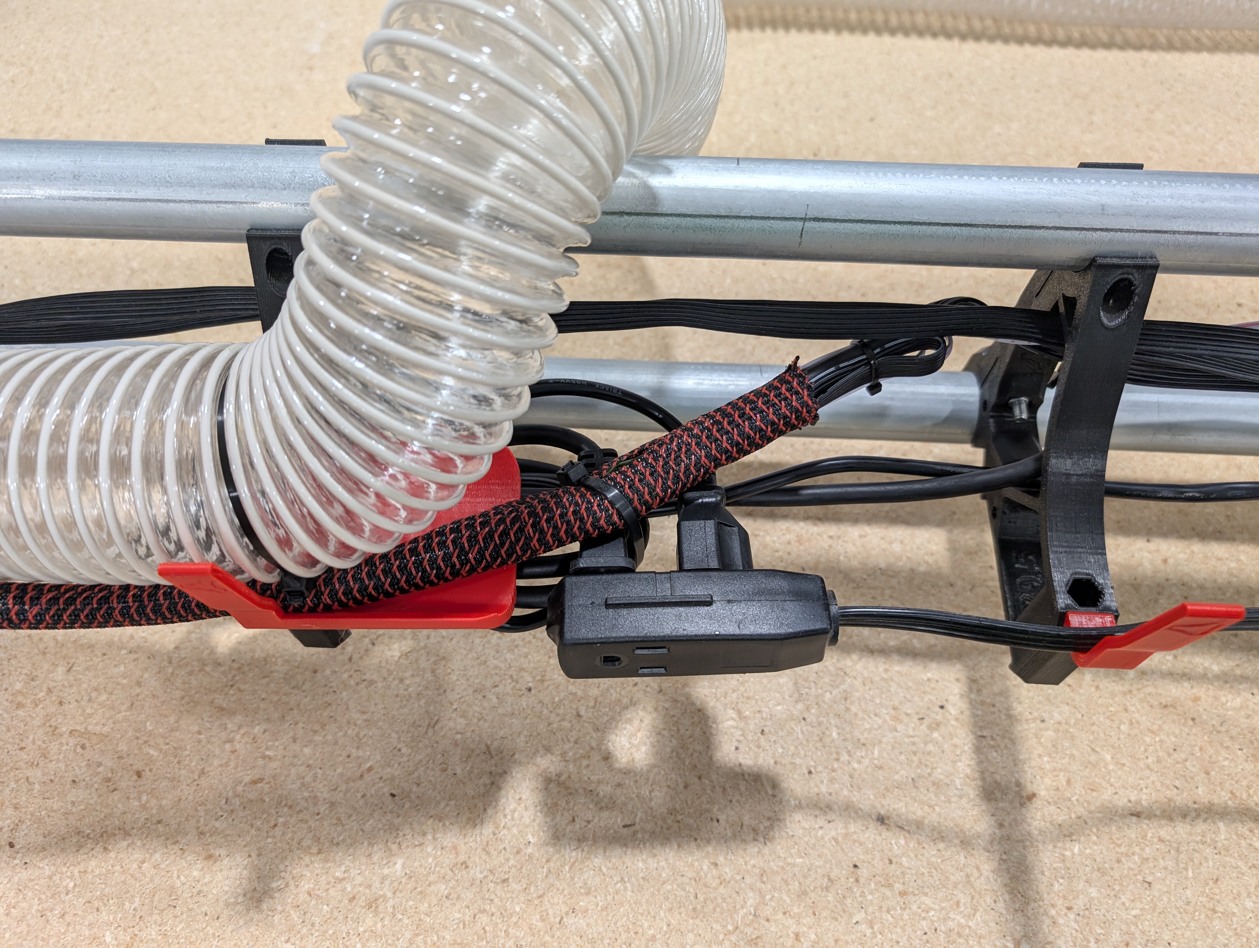

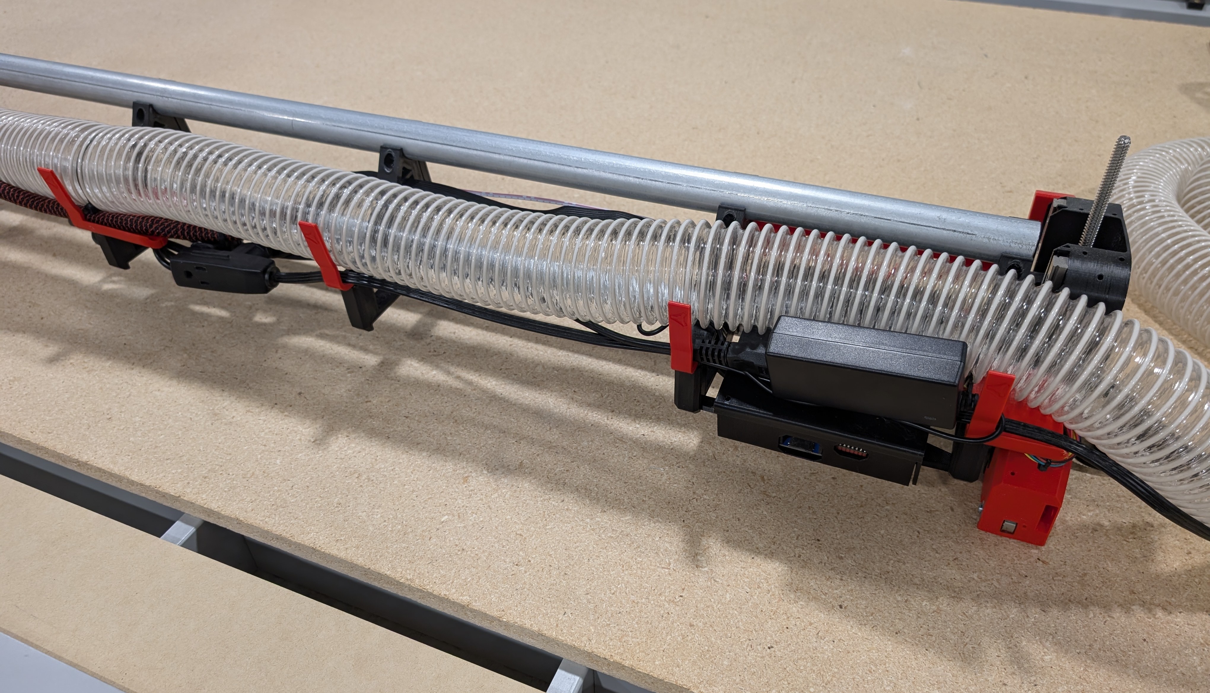

*3 Vac Hose Optional 2.5” (70mm) OD Vacuum hose steel rib – Amazon
As an Amazon Associate, I earn from qualifying purchases.
*1 Threadlocker is recommended for the pulley grub screws, it is not included in the kits due to import regulations.
*3 Vac Hoses need to be grounded at one end. Using a steel ribbed hose makes this very easy to use the ground port from your power source. If you use a non-conductive vac hose you can run a bare wire through the hose secure at one end and ground at the other. If you do not ground your hose static will build up and can damage your control board or other components.

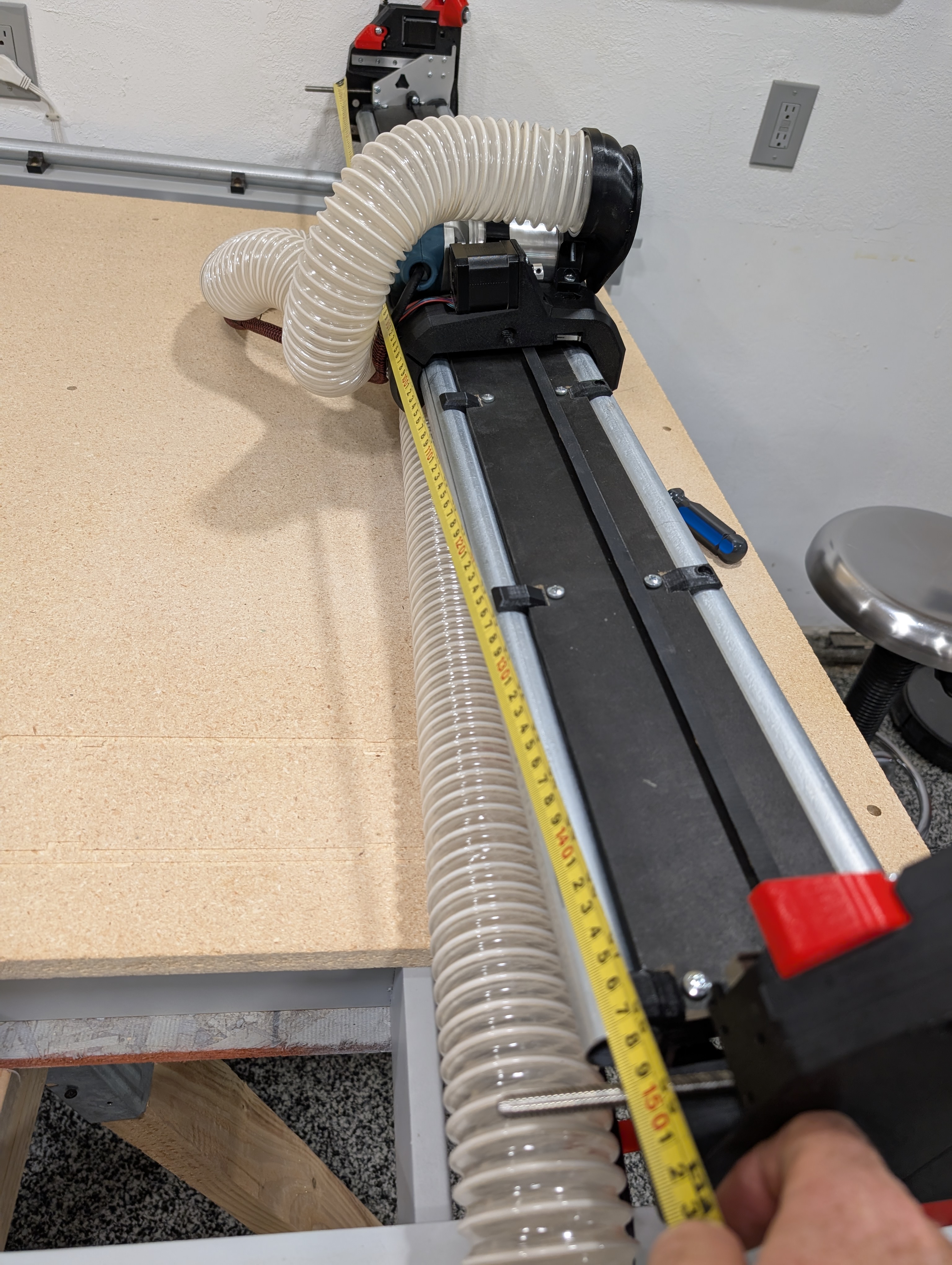

This is what is needed for a 4’ x 8’ (1.2m x 2.4m) build. You will need more or less depending on what size you build. M8 or 5/16 should be hex head bolts.
QTY Description US Equivalent
14 M8 x 40mm Hex Head 5/16” x 1.5” Hex Head
14 M8 Nylock nuts 5/16” Nylock
60 M5 x 30mm Machine Screws, Button Head Must be metric
60 M5 Nylock Must be metric
83 M3 x 10mm Machine Screws, Button Head Must be metric
10 M2.5 x 12mm Machine Screws, Button Head Must be metric
*18 M4 x 12mm+ Wood/metal #8 x ½“+ Screws to mount things to your table
* Not included in the hardware kit. You might also want different lengths to accommodate different material thickness.

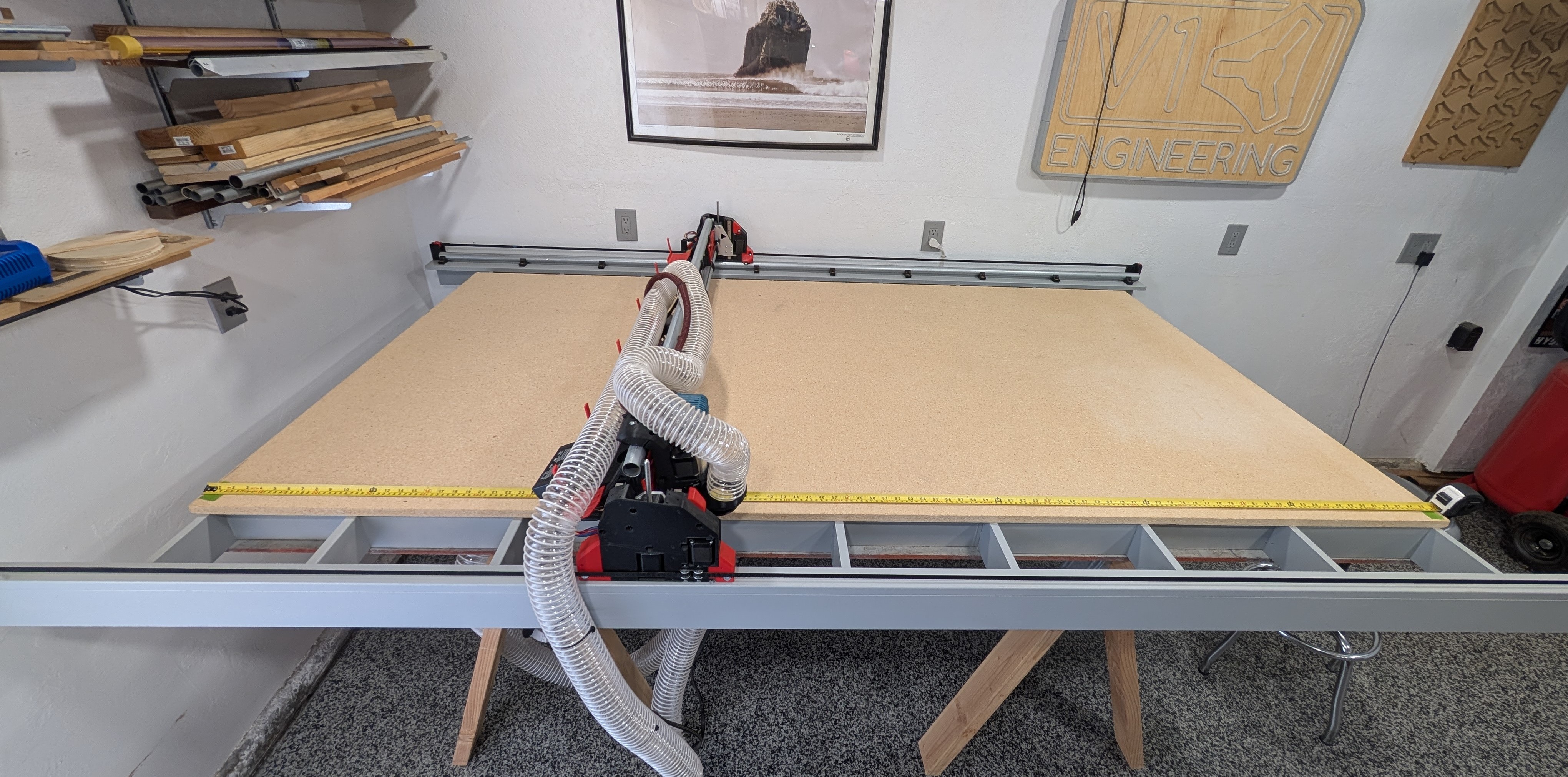

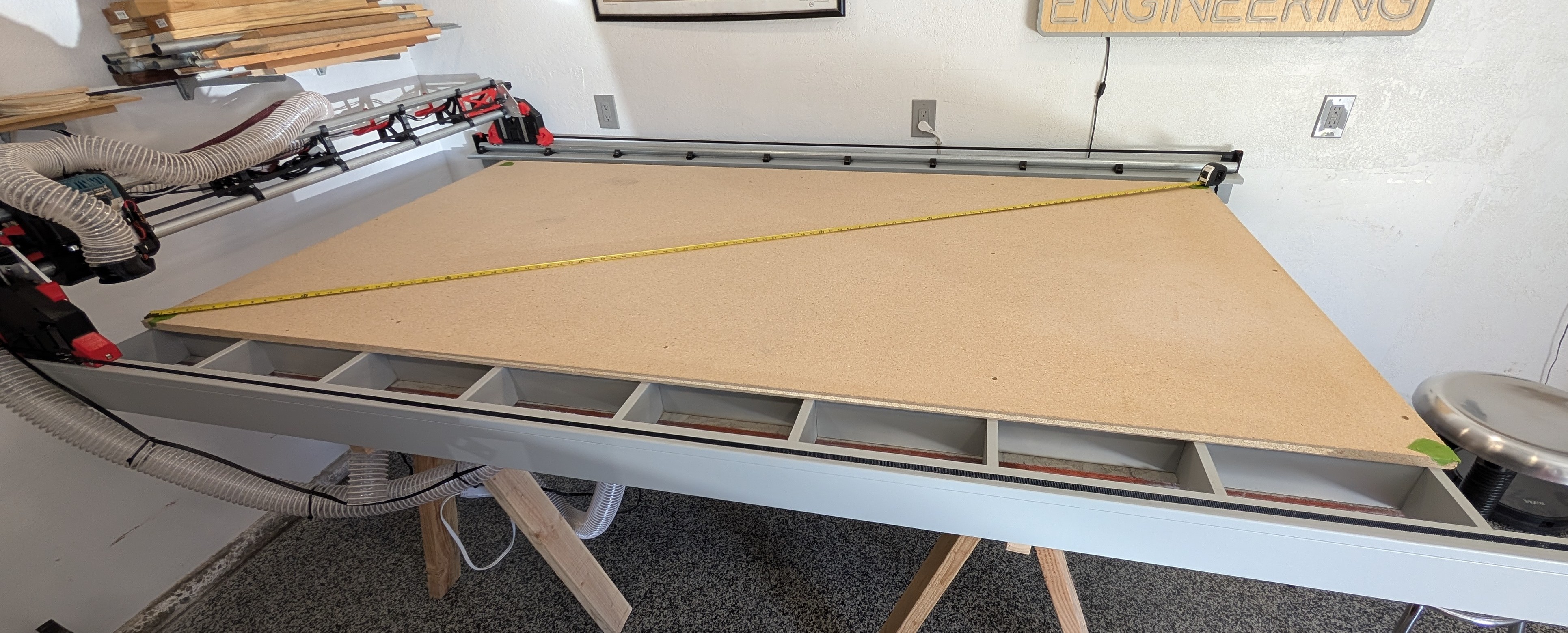

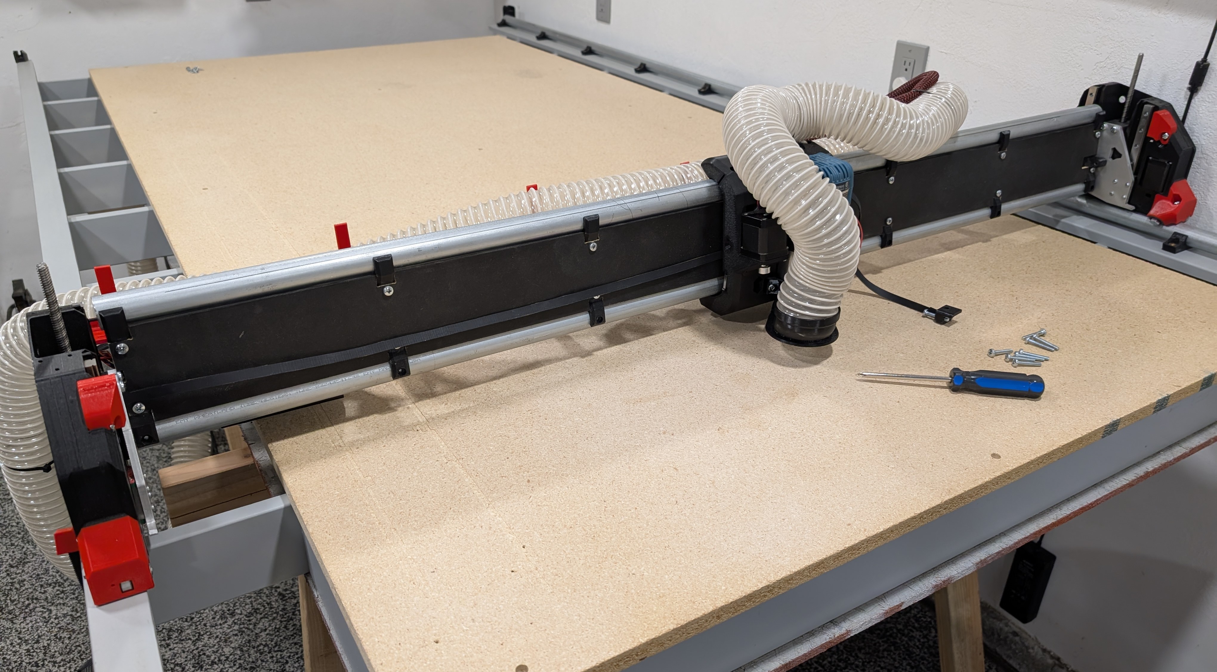

Table
Your table needs only be as fancy as a sheet of wood on a relatively flat, smooth surface. A CNC machine can self correct many of its own imperfections if needed. Typically, our tables only support the CNC and some material, so nothing heavy duty is required. Stability is the main goal of your table.
Any existing table that is large enough is fine. You can use its surface directly, or a more popular option is to add a waste board of some sort on top that is replaceable as it gets used and cut into.
Next option would be to build a basic table with any material that is easy to source for you. Accuracy is not super important, but the more square and flat you make it, the better. A simple 2x4 table with an MDF/plywood/OSB table top is most common.
If you have a table saw, circular saw with a guide, or a CNC machine, a Torsion Box table is pretty easy to make and can lead to a very stable surface that will last a long time.
  • ~\(200-\)400 basic table plans, from the V1E.com forums LR4 tables.
Calculator for table, rail, and belt lengths

!LR4 main assm
  • Double check that the lower X rail is not touching either metal XZ plate.
  • If it touches your machine will most likely have driving or lifting issues.
!LR4 main assm
  • You can do a quick check with a square to see how your sides are angled.
  • If you don’t have a square this will get checked in the next section in another way.
!LR4 main assm
  • Okay now is a good time to make sure your heal toe measurements are equal.
  • Roughly set the beam level by turning the Z axis leadscrews, one side is different so the side plates will be at different heights.
  • Simply measure across the front of your machine from the side plates (not the wheels as those can move).
!LR4 main assm
  • Now measure across the back
  • The two numbers should be nearly identical.
  • If they are not the machine can wander when not under power.
  • The adjustment would be to check your end braces and if needed you can loosen your temp struts and straighten the sides out.

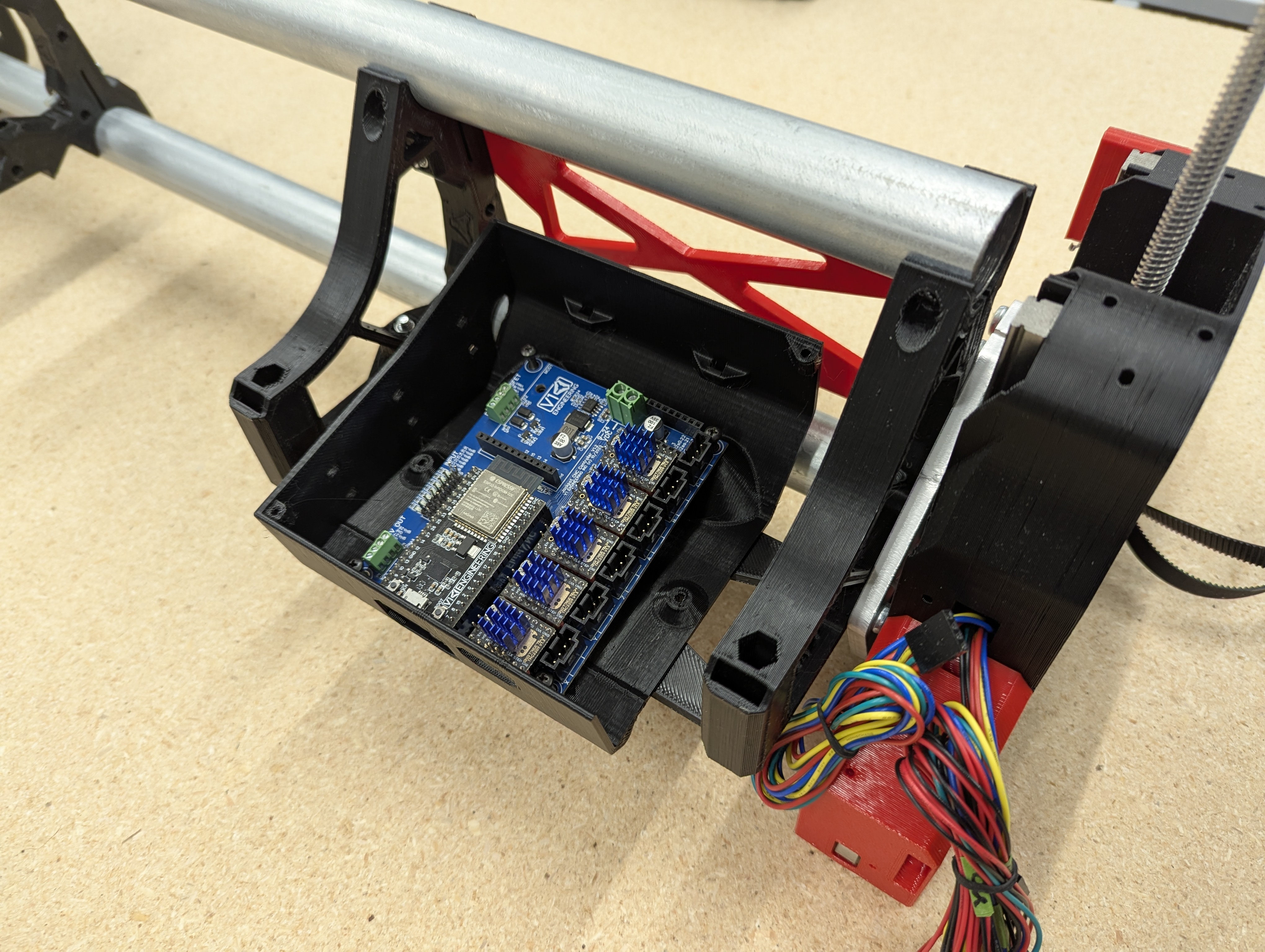

  • Find a good home for your control board. The YZ_Min side as shown here is recommended.
  • The first bay makes wiring the easiest, as well as SD card access.
  • Jackpot Wiring, Other boards will be similar. You will start routing the wires to your controller.

  • Run your wires from the YZ assemblies to the beam with the beam at full height.
  • Feed the wires from the YZ assembly into the beam and secure them to the brace.
  • Make sure the travel is free, clear, and smooth. The wires should have slack at all positions, test this by moving the beam up and down.
  • Cable ties, wire ties, or tape to the braces work well to hold the wires in place.
  • Wire cover is nice but not needed Shop, Amazon.

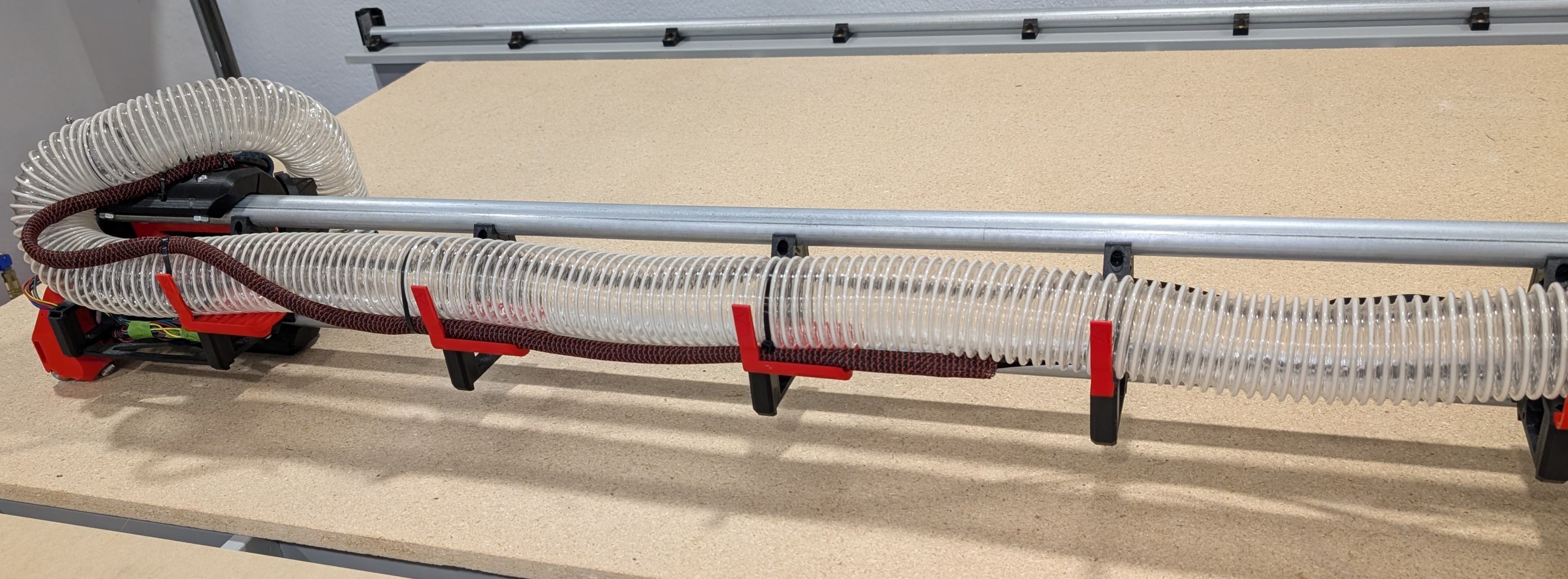

!LR4 Wire Routing
  • Move the core all the way to X_Max, the YZ_Max plate.
  • Secure your wires to the first position at the top of the Core.
  • Add in the Hose_Hooks to hold the wires. (new hose hooks, the longer ones go where the hose moves, short ones ho on eth middle and end brace)
  • The wires and hose get secured to your middle brace, the number of hose hooks vary depending on build size.
  • Leave a small loop in the wires at the max position.
  • You will be securing it the the brace just past halfway.
  • If you are using a router set it in the tool mount and run the power cord along with the wires. Leave a little cord room for router adjustment in the tool mount.
  • Later when the vac hose gets added the wires get secured to it.
!LR4 Wire Routing
  • The Core wires get ran to the half way point and then into the braces with the other wires.
  • They wires get plugged in and then bundled neatly.
  • Carefully make sure the Core reaches both ends without pulling on the wires.
  • You can add a little partial twist in the wire bundle to make them behave properly when the core moves.

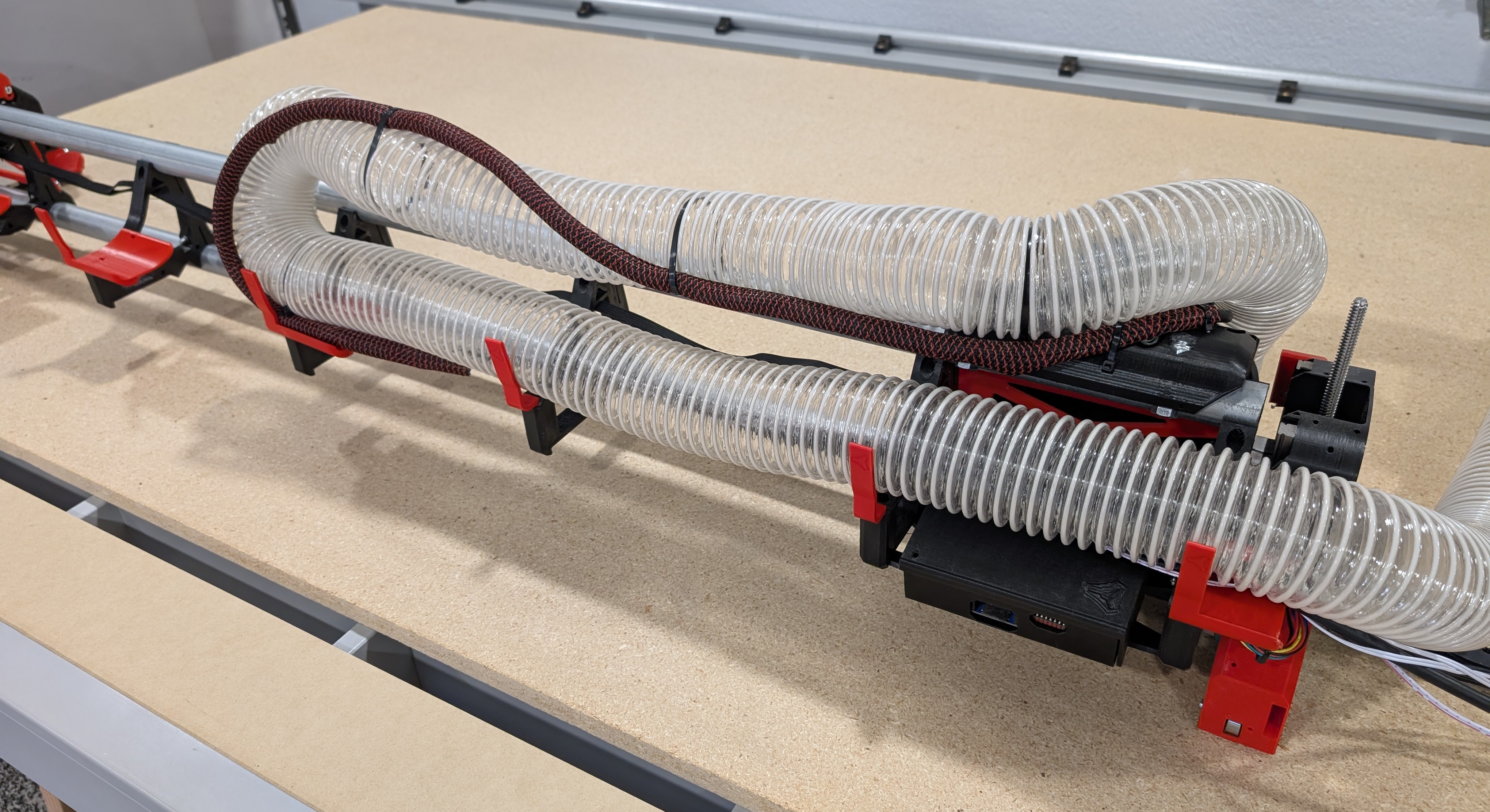

!LR4 Wire Routing
  • When adding in your vacuum hose connect it to your dust shoe, and up to the second mounting hole in the top of the Core.
  • The hose gets secured to your middle brace and the Hose Hook. If needed add a partial twist so your hose tracks properly to both extremes and does not fall over the front or the back of the CNC.
  • The picture shows an easy way to route the wires and hose together. The wires cross under the hose after the middle brace.
  • Secure the wires to the hose just after each hose hook. You can secure them either just above the hose hook or in the corner. Both are shown in this picture.
  • It is best to pass the wires under the hose at the middle position, not over as it can snag.
  • The hose and wires are secured to the middle hose hook part, cable ties or tape will work.

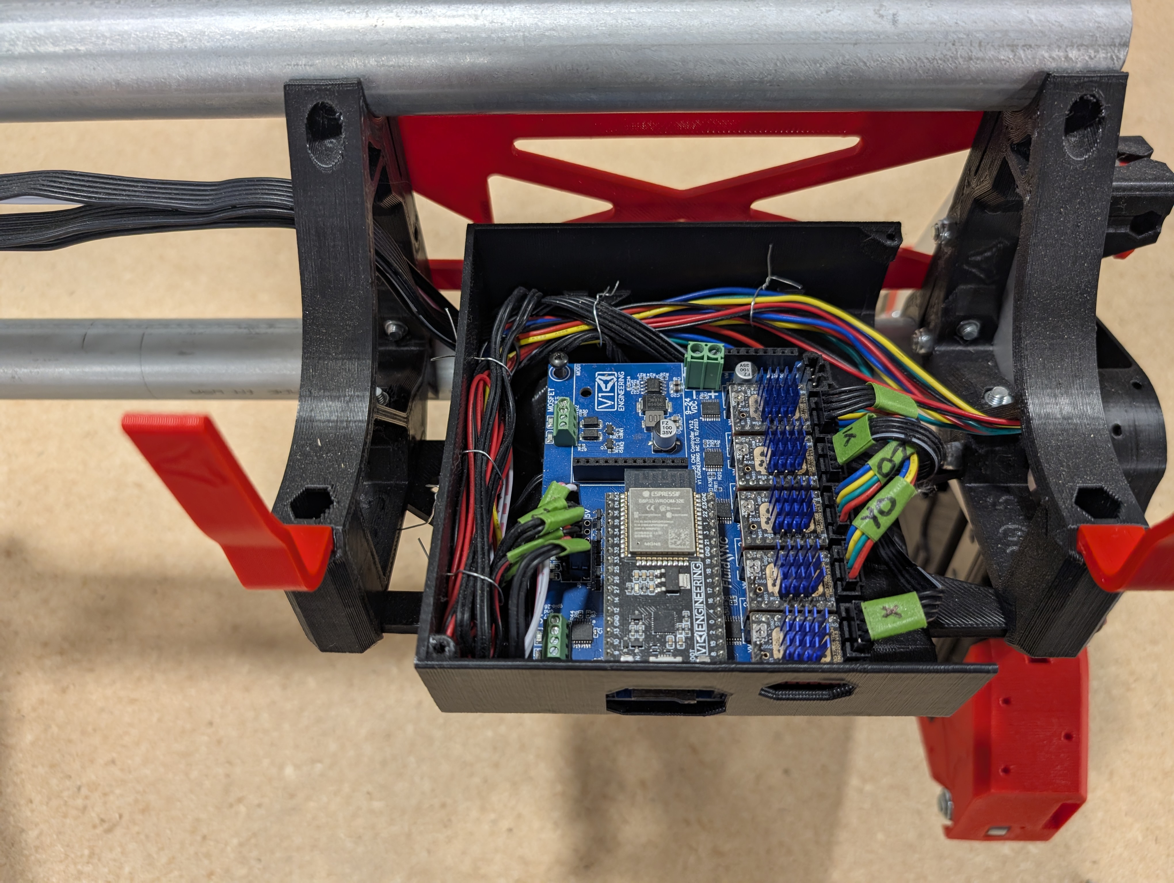

  • Run the YZ Min assembly wires.
  • The slack can get bundled on either side of the board box.
  • Leave the board box as open and uncluttered as possible for easy air flow.
!LR4 Wire Routing
  • Leave the board box as open for air flow as possible.

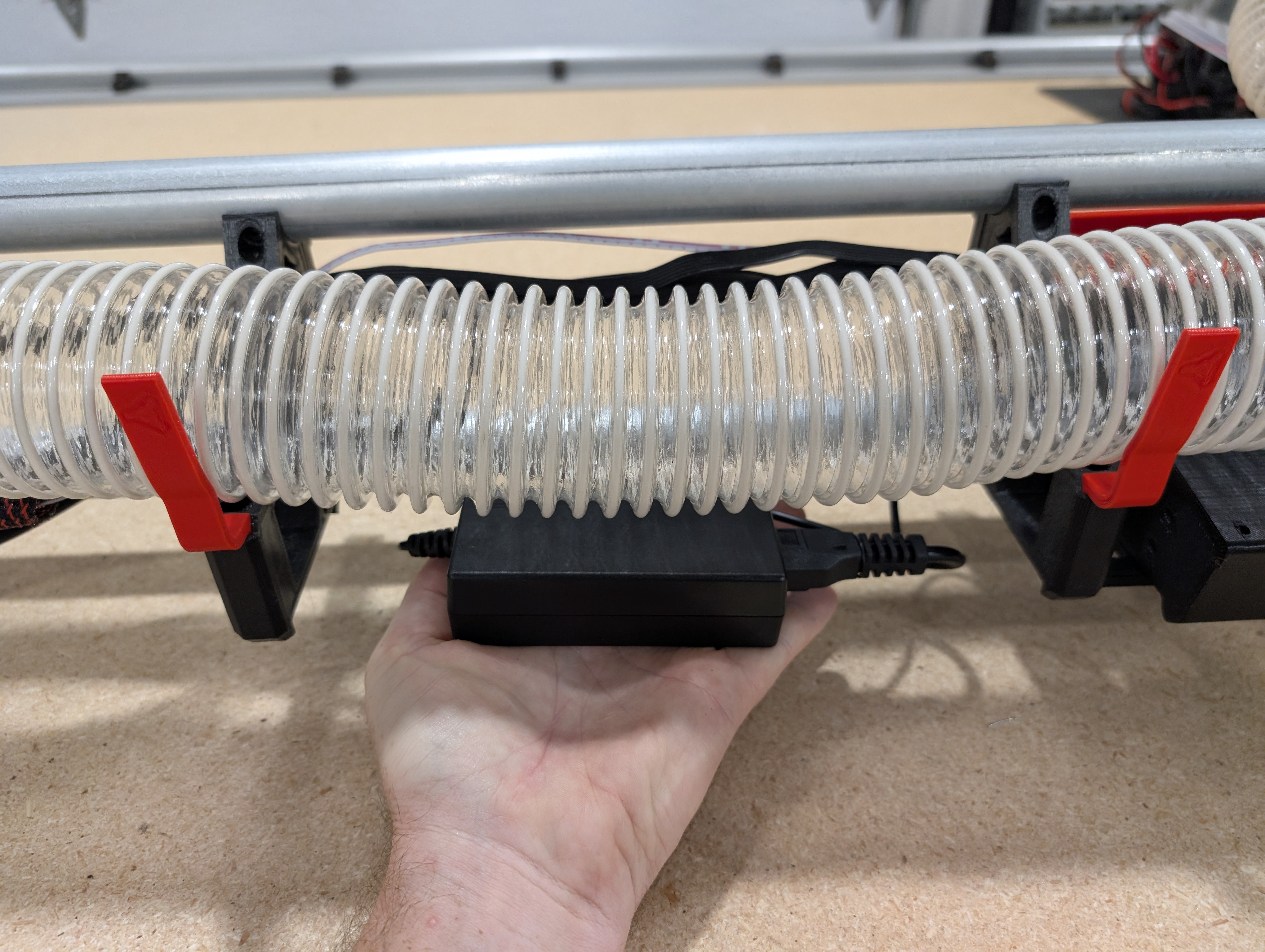

  • After the strut plates are cut the power supply will get mounted here.
  • Size your wires to give you some room to work. Connect to your control board and run the power cable.
!LR4 Wire Routing
  • For now just flip the power supply to hold it in place on your hose hooks.
  • When the strut plates are done This will get more permanently mounted.

  • First step to mounting the CNC to the table is setting the Y rail
  • Do your best to make a perfectly rectangular table, but once the rail is set that becomes your reference, so do your best to make your rail parallel to your table edge.
  • The belt holders and Y_Clips all share the outer edge, using the same reference.
  • The calculator “table measurement” gives you the exact outside dimensions of the belt holders as the footprint.
  • No more than 300mm gap is recommended between Y_Clips.
!LR4 Belts
  • Pre-drilling is highly recommended so your parts lay flat on the table when screwed down.
  • You can draw a screw hole centerline down the table to make this easy.
  • There is +-1.5mm so each clip has a little wiggle room if your holes are not perfect.
  • Best to set both Y Max belt ends and the first and last Y clips on the table first.
  • Then measure the remaining gap and equally divide the rest of your clips.
!LR4 Belts
  • Make sure both Y Min belt holders get an M3 screw fully inserted
  • This is for coarse Y squaring adjustment screw
!LR4 Belts
  • Trick for marking the holes is an over sharpened pencil
!LR4 Belts
  • Both ends get set and pre-drilled.
!LR4 Belts
  • The first clip get attached directly next to the belt holders on both ends.
!LR4 Belts

  • Now the X belt
  • Wrap around an M3 screw
  • You can pinch the belt and hold it in the metal XZ plate as you work it in further.
  • North Woods Custom Creations made a video below.
!LR4 Belts
  • Push the belt and screw to the bottom with a screw driver
!LR4 Belts
  • Load the belt into the X Belt tensioner
  • Make sure to get the distance right
  • Move the core back and forth SLOWLY to make sure the belt is on the pulley and idlers properly
!LR4 Belts
  • Tension to ~7lbs (3.2kg) same as before. Loose is better than breaking things.

I prefer to use a V-Bit in the router, but you can use the pen mount to mark a small dot as well.
!LR4 belt calibration
  • I use tape at each end, so I can be sure I am using the correct mark. Swap out the tape with each test.
  • Home the X and Y axis.
  • Use the Z axis to mark a small dot at near your table edge.
  • Move your machine to the far end of your table, keep track of how far you asked it to move, and make another mark.
  • Move the CNC out of the way.
  • Measure these marks to the best of your abilities.
  • Here is what the dot looks like from a V-bit
  • It is best to get a helper to hold one end while you read the other.
  • Verify your new settings, usually one try is all it takes and this should not change.

To square the machine, it is easiest to mark 4 points and measure the diagonal. This is how we set the Y axis to square the machine relative to the rail every time you home. You will probably need to repeat this a couple of times to get it under 1mm difference. This is a multiplied error, so 1mm or less is very very good.
You can use a V-Bit in your router to pop a tiny hole into some tape, or use the pen mount to mark some points/dots. You can easily move the router manually or here is a sample Gcode you can edit to suit your build size and speed up the tests.
$H ;Home all three axes
G1 X30 Y30 F6000 ;Move to starting corner
G1 Z-98 F6000 ;Move down to mark first hole
G1 Z-78 F600 ;Lift Z axis up before it moves
G1 X1190 F6000 ;Move to right side
G1 Z-98 F600
G1 Z-78
G1 Y2400 F6000 ;Move to back right
G1 Z-98 F600
G1 Z-78
G1 X30 F6000 ;Move to back left
G1 Z-98 F600
G1 Z-78
G1 Y1200 Z0 F6000 ;Move out of the way so you can measure

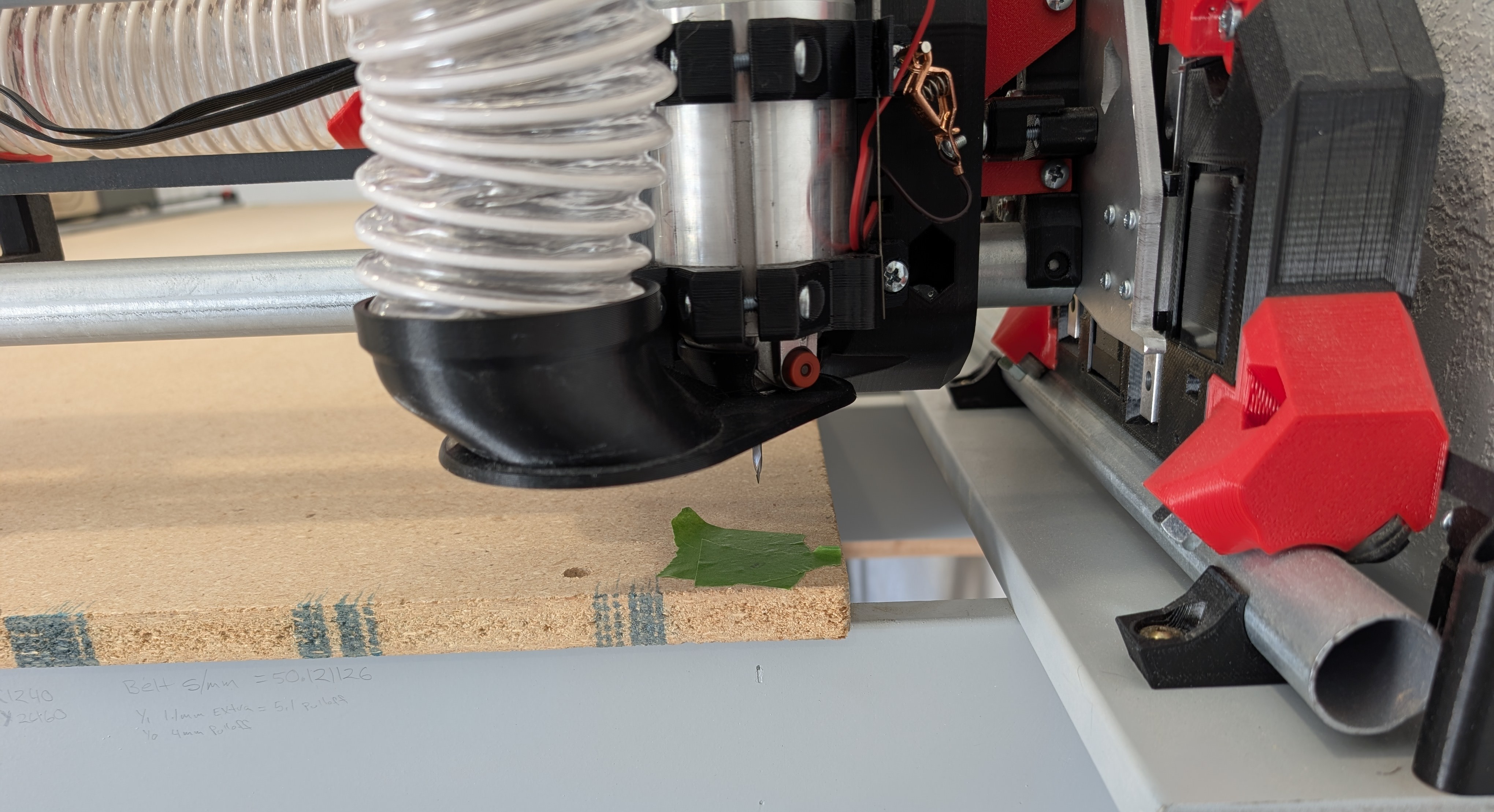

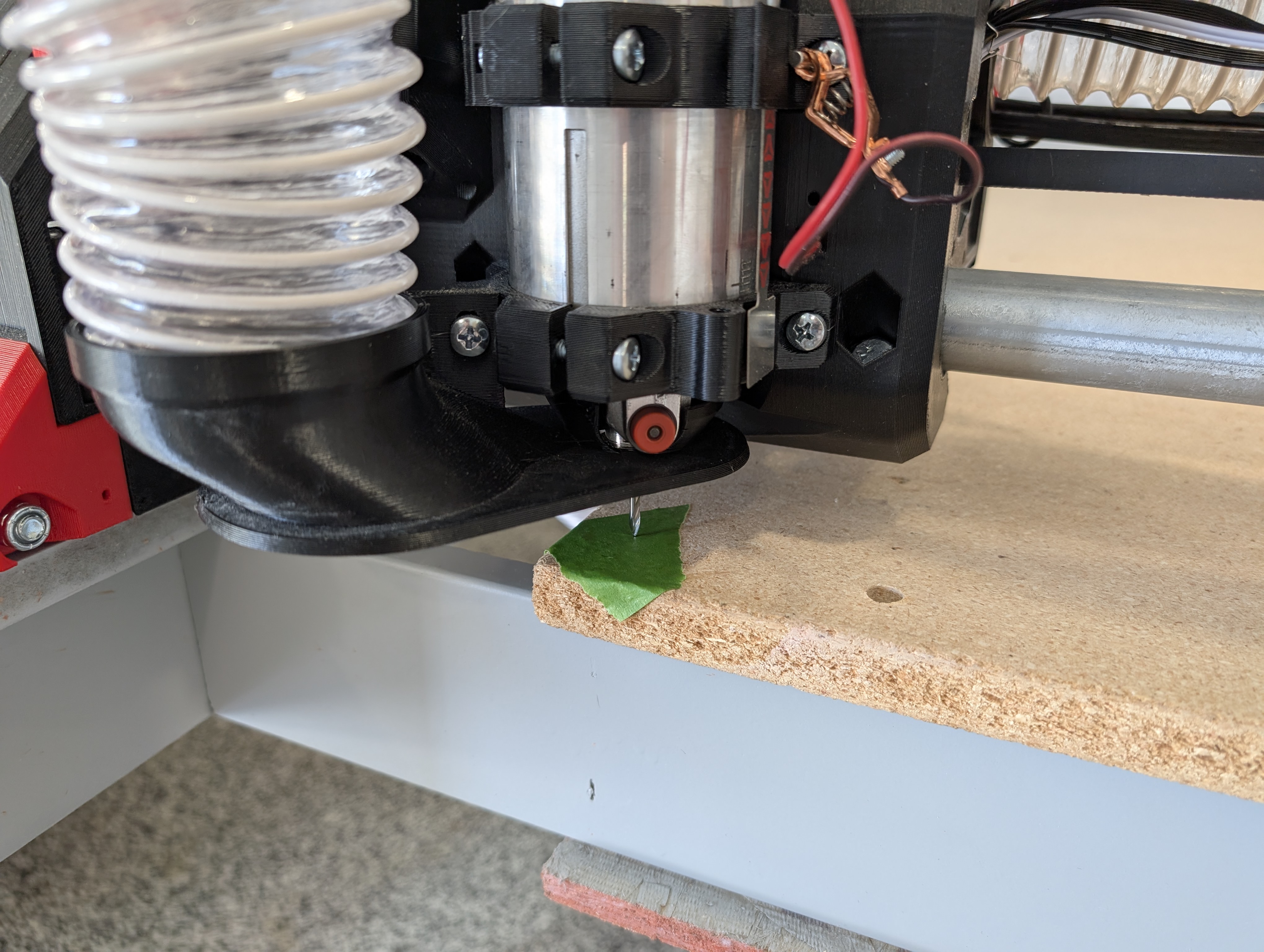

  • I use tape, so I can change it out to be sure I am using the correct mark each time.
  • Home the X and Y axis. This step is important.
  • Use the Z axis to mark a small dot at 0,0.
!LR4 squaring
  • Now drive the machine to your X axis furthest point (or close to it).
  • Use the Z to mark the dot.

!LR4 squaring
  • Now measure the diagonal to the best of your ability.
!LR4 squaring
  • Now measure the other diagonal to the best of your ability. Note the longer one, and subtract to find the difference. Under 1mm is very good.
If you have a difference, you have a parallelogram, instead of a rectangle. Corrections should be made if you are over 2mm of difference, depending on your use case. A good first guess for your offset is half the difference in your measurements. The corner nearest the endstop that is associated with the longer of the two diagonals needs to move further from the Y hard stop. You do this in the firmware.

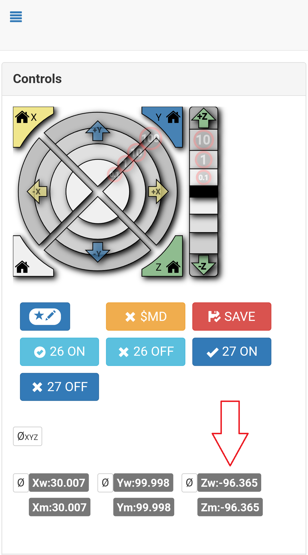

Coarse adjustments can be made with the Y-axis endstop screws. Turning them too far in can lead to hitting the hard stops before the switches, too far out and you can run the risk of popping off the endstop levers.
In the WebUI you can add to your Y axis pull-off distance to correct any skew. Back on the main screen use the “Save” macro to make the changes stick after a re-boot. This is a little different on the UI V2 and V3, the important part is using the save macro.
Use the terminal on your SKR Pro or a USB connection and repetier host to add a homing offset. “M666 Y0.5” will move your Y1 stepper 0.5mm away from the stop block after it homes. “M666 Y-0.5” will move your Y2 stepper away instead. You want to move the longer dimension side away from the block. Now Use “M500” to save it to the EEPROM. Re-home X and Y and test it again.

  • Z leveling is a bit easier than the Y axis if you have a touch plate. You can also use any sort of block or piece of paper as a feeler gauge.
  • I move 30-50mm in from each edge when I test, front and sides.
  • If you are using a touch plate you can tape it down to increase your accuracy.
  • Home the z-axis.
  • Set the Z position to 0, in FluidNC that is G10 L2 P0 Z0, in Marlin that is G92 Z0.
  • Very slowly, Probe to the touch plate (or whatever feeler gauge you are using).
  • In Fluid NC probe to a touchplate looks like this, G38.2 Z-100 F60, in Marlin it is G38.2 Z0
  • Make note of the current Z position, do this at least 3 times on each side and average the position.
!LR4 squaring
  • In FluidNC this is your current Z position
  • In marlin this will say on your LCD screen, or your gcode sender.

Making the Strut plates
At this point you should be ready to make some cuts, you should have made your own gcode and done a few test cuts to get familiar with everything.
Those links in case you need to reference them. Basic software setup, Basic CAM settings
The two strut plates should be 6.35mm (¼“) or thinner of MDF or similarly rigid material, no ¼” ply, that is just too soft. Plastic or metal are fine, just harder for a new CNC user to cut.
!LR4 Strut Plates
  • Getting ready to make your first cuts all starts with loading the material.
  • Check to make sure your material is relatively square on the machine, the larger your material the less you need to worry about this.
  • Secure the material and make sure your endmill will not hit as it passes near it. I use screws with large heads.
!LR4 strut plate Picture
  • Use calculator and the Vector76 Strut Generator output to make your custom file.
!LR4 Strut Plates

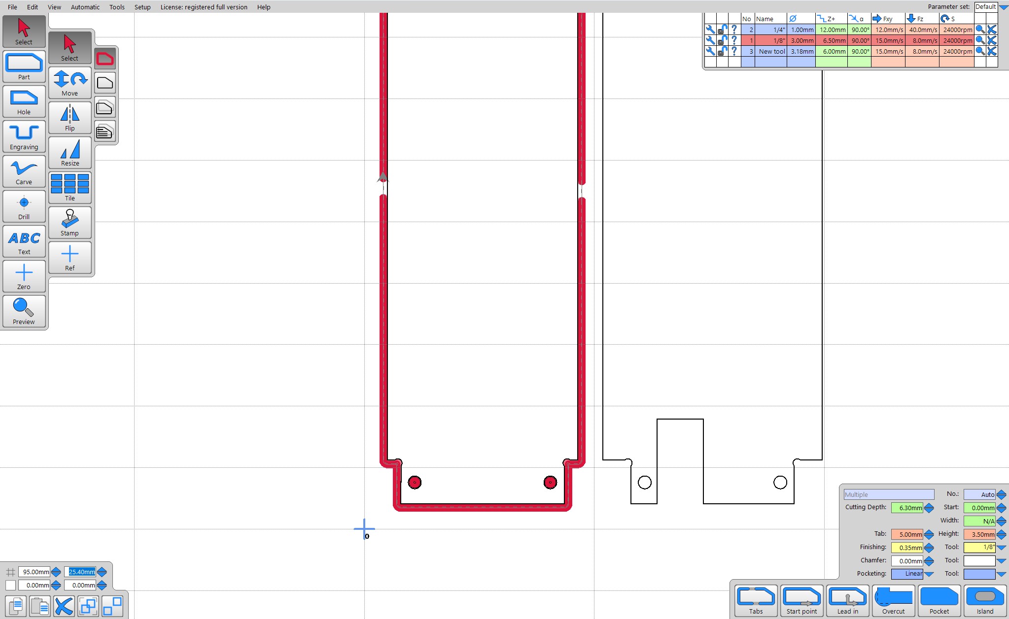

  • In EstlCAM you can open that svg file using Millimeters.
  • You will need to rotate the drawing layer 90 degrees
  • Also move your Zero near the lower left corner.
  • The zero position is where you will move the machine to after homing your CNC.
!LR4 Strut Plates
  • Beginners should only cut one plate at a time, so you can adjust any settings if needed.
  • Drill all the holes first

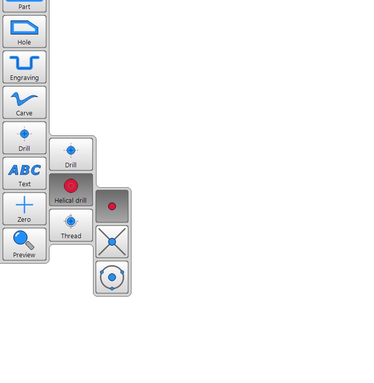

  • Helical drill will get you those perfect larger diameter holes with the smaller endmill.
!LR4 Strut Plates
  • Use “Part” to cut outside the line.
  • Make sure to use several “tabs” to keep your part in the material after it has been cut out.
!LR4 Strut Plates

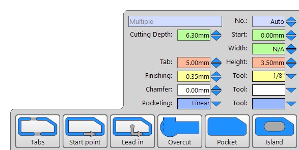

  • You can use the “Select” tool to drag a rectangle around the entire project and select all the paths
  • Now you can adjust all the setting to match. Depth of cut (at least 0.2mm further than your material), finishing path size and tool, and tab width and thickness.
  • Export your program and cut those parts!
Temp to Custom Strut Plates
Now to put the new strut plates on your CNC. I like this part as it gives you a second chance to clean up any sloppy wiring and finalizes the CNC.
!Strut Plates
  • Swapping to the custom strut plates is pretty easy.
  • Start by removing the X belt, and both Y belts.
  • Bundle and rubber band them to help prevent them with snagging.
!Strut Plates
  • Loosen and remove all the front plate X rail screws.
  • Remove all four temp strut plates.
!Strut Plates
  • To remove the Core, you can remove the whole side or just slide out the top rail enough to slip off the Core.
  • You can also slide the Core to the far end and shimmy the strut plates under it, to me that is a little harder.
!Strut Plates
  • Add the front strut plate, you will need to line up the braces.
  • It can be tight, some tips are put the plate straight in, if you try to wedge it top to bottom it is harder.
  • Do not push too hard or you can crack your plate.
  • If you are having issues you can pop the two rails out and that gives you more room to put the plate in, put the rails back before the screws.
  • Add the screws in. Keep them loose as you might need to shimmy things around a little. You will snug these later.
!Strut Plates
  • Put the core back on.
  • Add the last two screws.
!Strut Plates
  • Add the bottom plate, same as the front.
  • One tip here is to tip in the X min side first to get the edge under the M3 bearing block screws.
  • Once you get all the bottom screws and nuts in lightly, you can go back and snug these up.
!Strut Plates
  • If you use a V1 board box you can use it to mark and then drill the holes in your strut plate
  • M3x10 to secure.
!Strut Plates
  • Okay now is a good time to double check your heal toe measurements are equal.
  • The last two screws on either side of the lower strut plate control your heal toe distance. This is just to make sure the front of your machine is the same width as the back of your machine.
  • Measure the YZ Plate, not the front or back wheel mounts since those can move.
  • Measure across the back of the yz Plates
!Strut Plates
  • Now measure across the front of the YZ Plate.
  • The two numbers should be as close as you can measure.
  • The adjustment would be to loosen the 2 or 4 screws on the lower strut plate and shift the plate a little bit, re-snug the screws.
  • The Pro-Tip here is if you can not get these right, chances are your lower X rail is too long. The lower X rail should not touch the metal XZ plate.
!Strut Plates
  • Snug up all of the front plate screws. Remember not to crush the braces, there should be a visible gap in the brace clamp even when snug. These screws are just there to keep the plate snug to the braces, clamping the rails are not a big deal.
  • Go ahead and put your X belt back on
