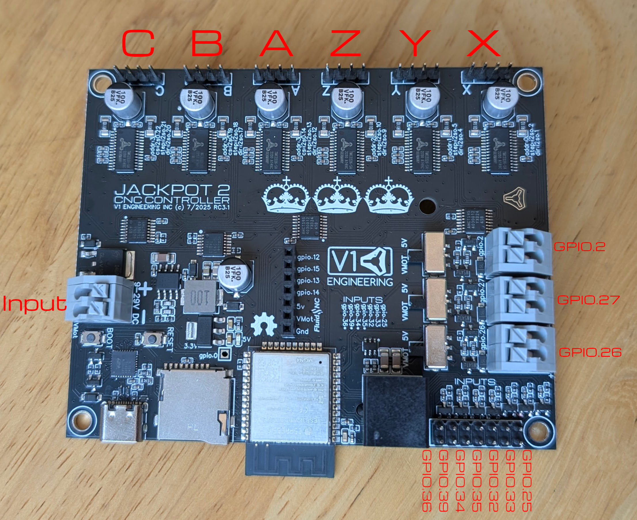

The Jackpot2 CNC Controller is a 32bit dual-core 240mhz control board.
  • Built in wireless control software
  • WiFi, Bluetooth, or hardwired capable (esp32).
  • 6x TMC2226 drivers
  • 7 inputs, 3x 5V or 24V(PS input level) outputs. NO PWM
  • One expansion FluidNC module socket (more IO, or other specialty add on cards).
  • MicroSD card slot.
  • Integrated RJ11 socket.
The Jackpot2 CNC Control board runs FluidNC which is fully GRBL compatible, with extended features featuring easy configuration and updating or GRBLHal.
Click here for full specifications
  • ESP32-wroom-32 Based control board
    • 32bit dual-core 240mhz board.
    • WiFi, USB Direct connection, or Bluetooth (rarely used).
    • Can have Onboard antenna
    • USB-C
  • 9-24VDC
    • Current required is a minimum of 19W (24Vx0.8A).
    • If you plan on using the high current outputs adjust accordingly.
  • 6x Integrated Stepper drivers
    • TMC2226 drivers in UART control mode only
    • The sockets are labeled XYZABC, but you can use any socket for any axis or motor number. The letters are just for reference only.
    • No Stallguard
  • 7x Inputs
    • All switch inputs are active low.
    • They have a 10k pullup external to the ESP32. The signal pin (S) should be connected to the ground pin (G) to activate the switch.
    • The input pins can be pins in the config file to use Normally Open or Normally Closed inputs.
  • 3x 5V or Line level outputs (same as input voltage)
    • Can be used to drive 2.5A continuously before they overheat. You can use them intermittently up to 3.5A.
    • They can be used with inductive loads (solenoids, relays, DC fans/motors)
    • See the “Spindle” section of the FluidNC wiki for common uses
    • No PWM, I made a mistake on teh circuit, the Jackpot3 will be PWM capable.
  • 1x Expansion Module socket
    • 6 PACK expansion module source
    • Buy Them
    • This should be able to use any CNC I/O module. Use an 11mm standoff or a 3D printed support in the mounting hole provided.
    • These Modules can be just about anything you need, pendant, more inputs, outputs, relays, spindle, VFD, Servo, OLED…
  • 1x MicroSD card slot
    • larger than 2gb needed
    • Fat32
    • 30 character or less file names, 100 character or less file location
  • Firmware
    • FluidNC
    • Text based config file for simple firmware edits.
    • No compiling to flash a board or change the configuration.
    • ~100% GRBL compatible
    • ESP3D-UI
    • Or GRBLHal

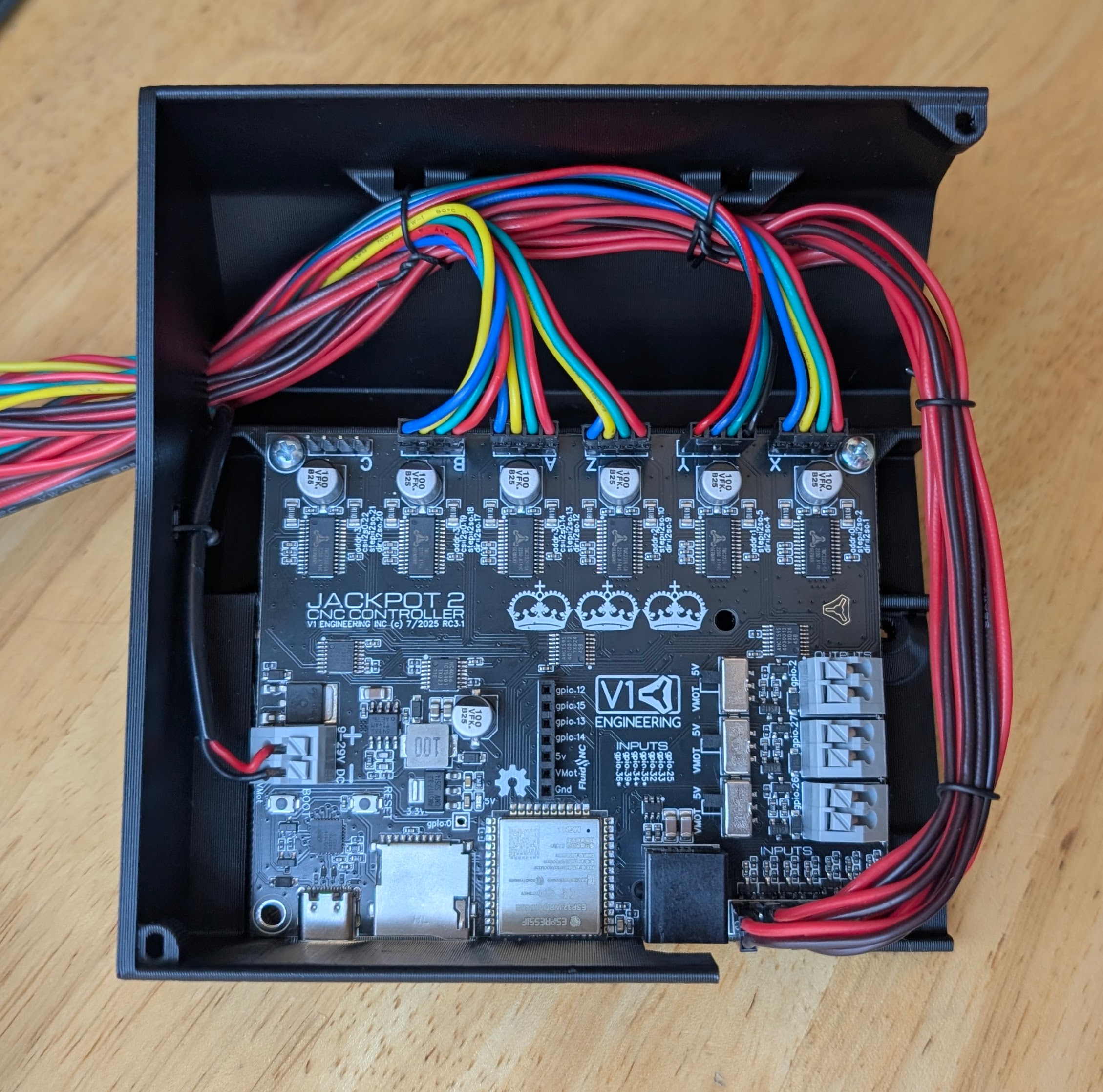

Wiring
Click on the image to enlarge it.
!Jackpot2 CNC LR pins
LR = X, Y0, Z0, Y1(A), Z1(B) MPCNC = X0, Y0, Z, X1(A), Y1(B)
The probe/touchplate plugs into the last port (gpio.36), on either configuration.
If you choose to use a case fan to cool your drivers you will typically wire the fan directly into the Jackpot2 main power so when the board is energized so is the fan. This means you need to get a fan that uses the same voltage as your power supply. We use a 24V power supply in the kit and sell a 24V fan in the shop.
Running the wires.
!Jackpot2 Clean Wires
Wires should always be ran beside the board never over, proper airflow is essential to a stable experience. Always secure all connections to the board before they leave the board box so they do not wiggle or vibrate loose.
Never cross wires over the top of the Jackpot2 antenna, this blocks the antenna signal.
