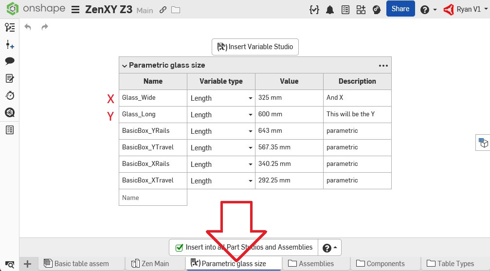

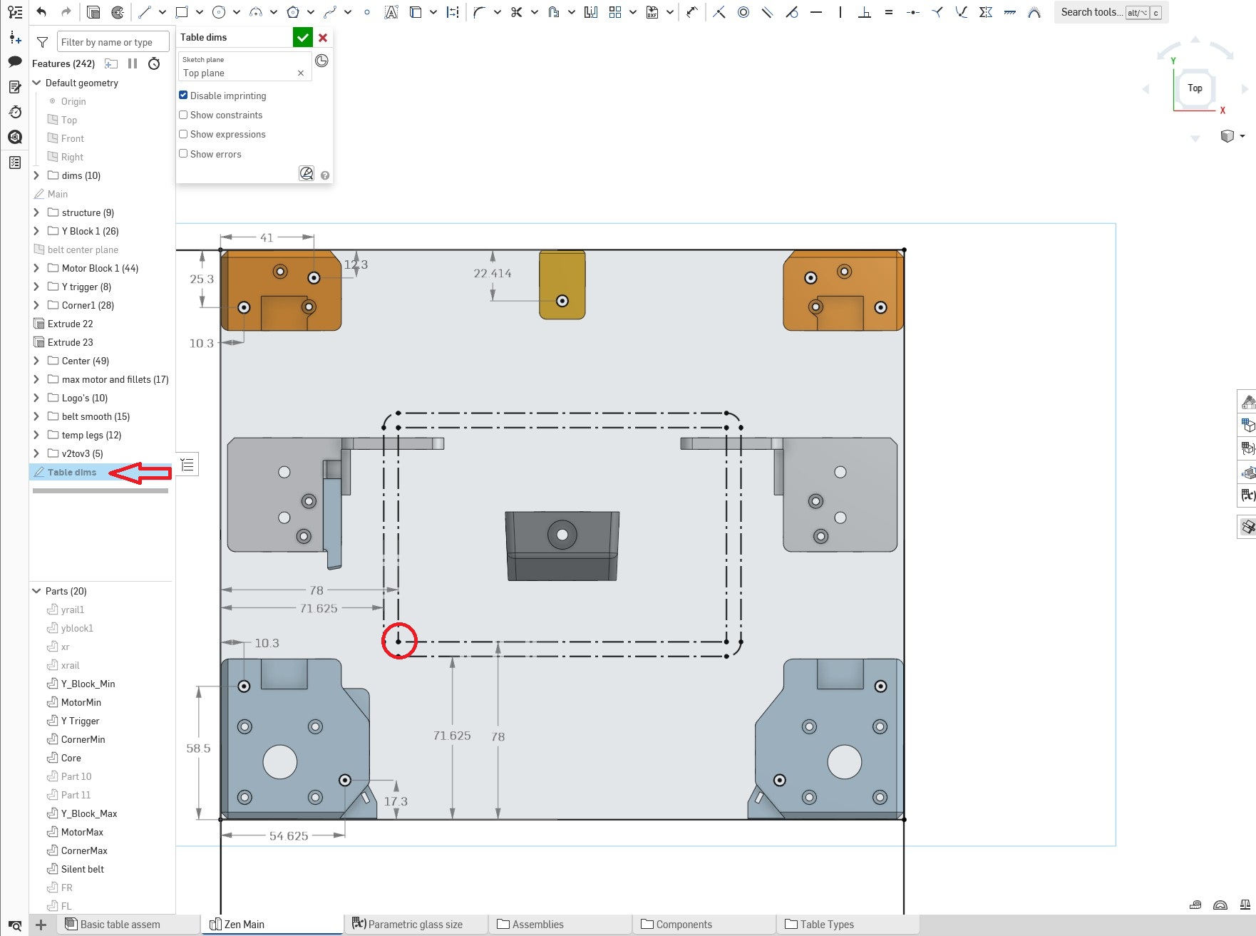

!ZenXY v3 parametric settings
  • Open the Parametric glass size tab.
  • Set your glass size here to adjust all the examples and files to fit your glass.
  • Each table has other adjustable parameters to fit your material.
In the CAD file the “Table Types” tab has 3 basic examples to build from. Find the table closest to your build style and you will see the Y Extrusions, X extrusion cut length, and approximate Belt Length shown on the upper left.
I use the printed parts to mark the mounting screw locations to pre-drill, but you can use the CAD to do it as well. There are two surface mounting screw options as well as a side wall screw option. Two screws are needed, more is optional
!ZenXY v3 screw locations
  • How to find exactly where the mounting screws are from the table edge.
  • In the Zen Main tab, open the Table dims sketch.

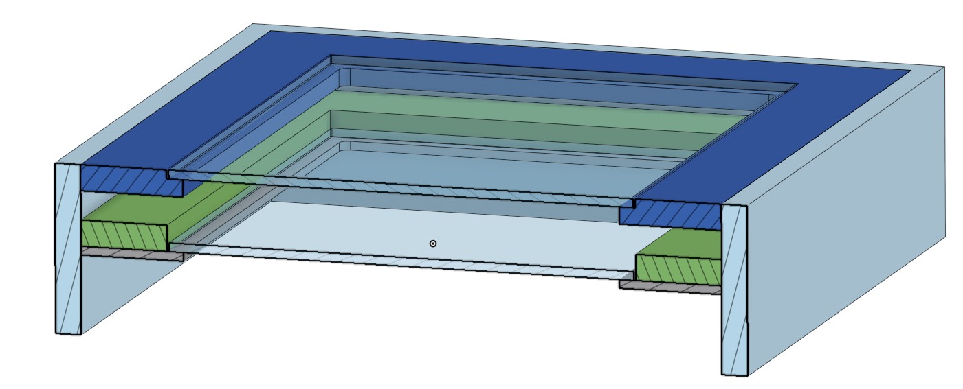

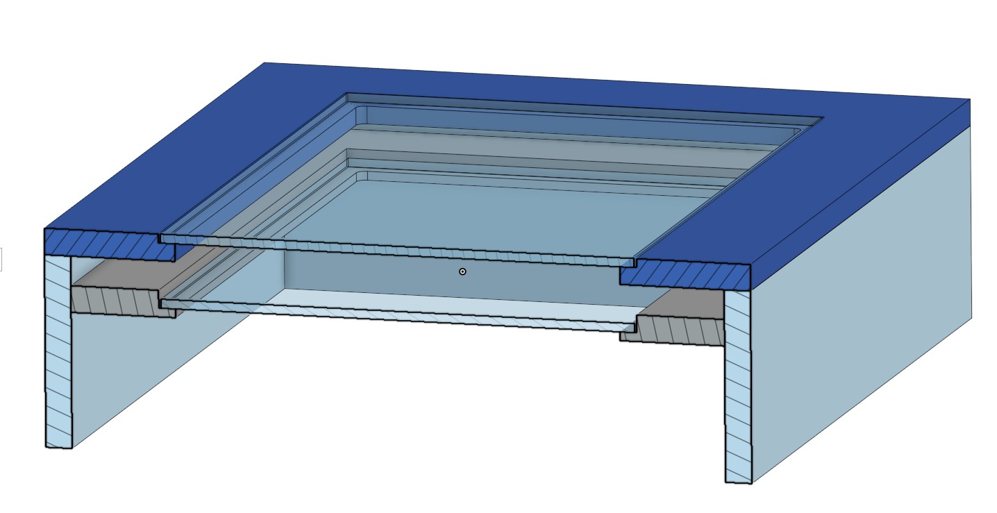

Example table

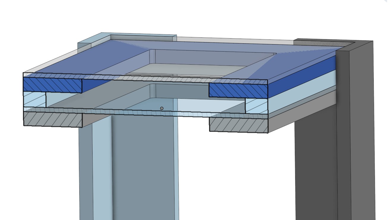

The table is usually based on the size tempered glass you can get. From there a pocket to support the edges or a slat build takes care of the rest. The CAD has a few simple adjustable examples of basic tables in the “Table Types” folder.
So far the cheapest small glass would be from Ikea, the BESTÅ. We were also told that for larger glass pinball suppliers carry new and used sheets for a great price if you have a shop near you. I personally got large tempered glass fence panels ordered in from my local big box store for a great price, some replacement shower doors with no holes would also work for larger tables.
Two pieces of glass work best, but if you are in a pinch in a small table a thin ¼” MDF sheet holds up for a while if your humidity is low.
!Simple ZenXY table
!Simple ZenXY table
!Simple ZenXY table In this table with larger glass and LED’s the edges of the glass have a subtle glow in a dim room.

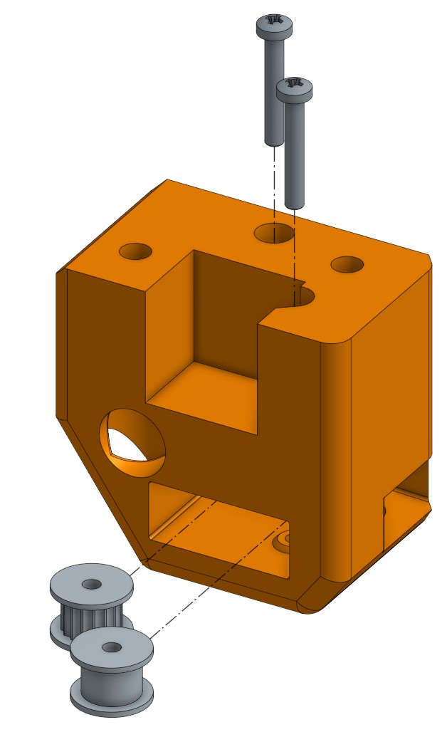

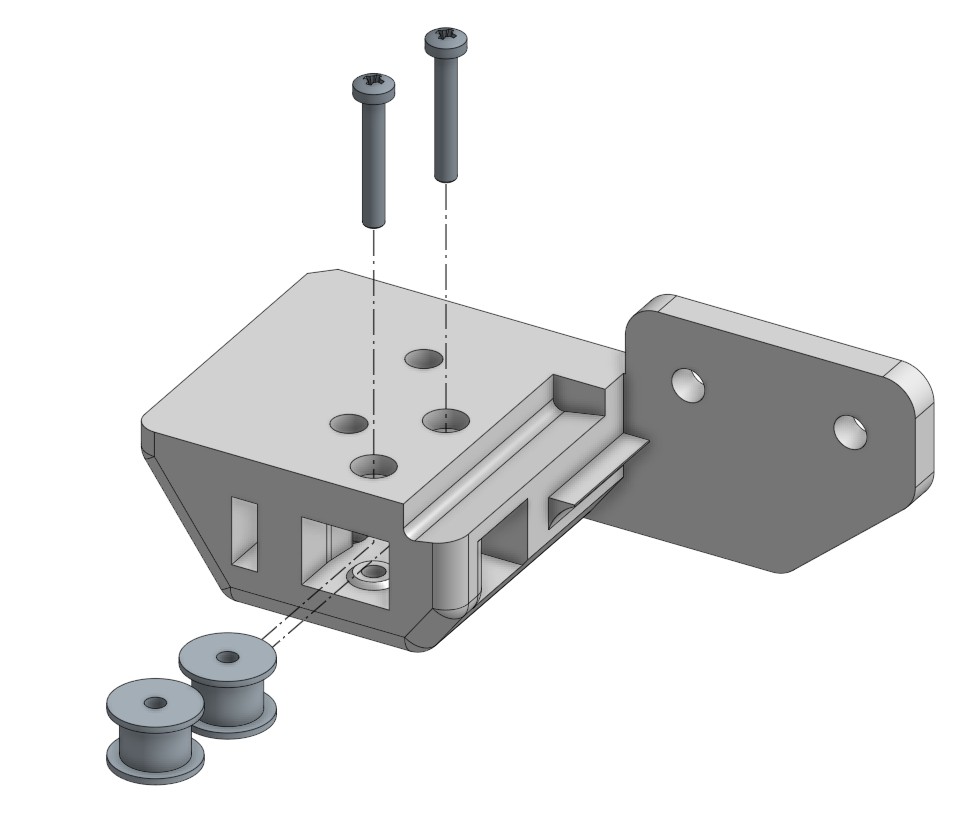

!ZenXY v3 corner assm
  • Using the CornerMin printed part
  • The toothed idler is inserted first in the deeper spot.
  • The smooth idler is second.
  • Both are secure with an m3, but the screw will not get tight is is lightly threaded directly into the printed part.
  • If you prefer a tight hold you can use a drop of glue.

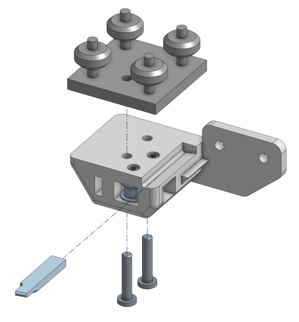

!ZenXY v3 yblock 1 assm
  • Use the M3 screws to secure the smooth idlers.
  • Gravity and the wheel block hold the screws in, they will only lightly thread into the printed part.
  • Do this for both Y_Block_Min and Max
!ZenXY v3 yblock2 assm
  • Use the M5 screws to secure a 50mm wheel block to the Y_Block assembly.
  • Make sure the eccentric wheels are facing out, or away from the large flat tab.
  • Do the previous two steps for both Min and Max sides.
  • On the Y_Block_Min, make sure to add the Y trigger
  • The Y Trigger will get adjusted later but for now make sure it is sticking out about 10mm.

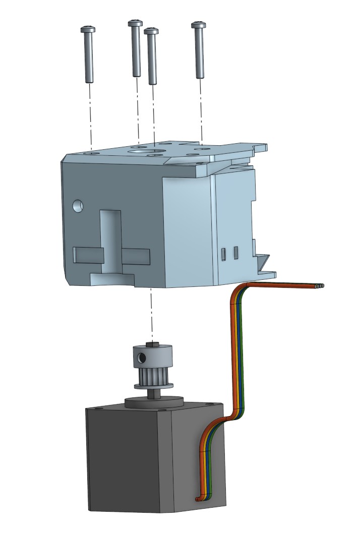

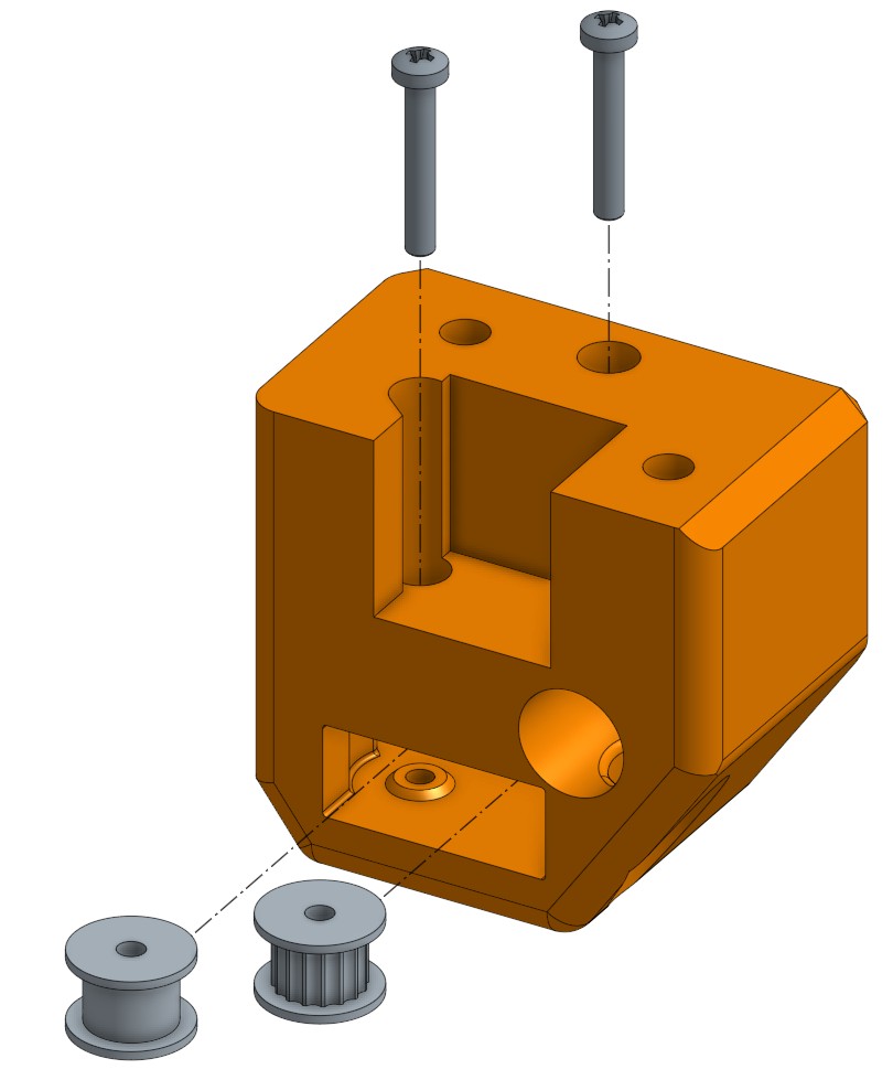

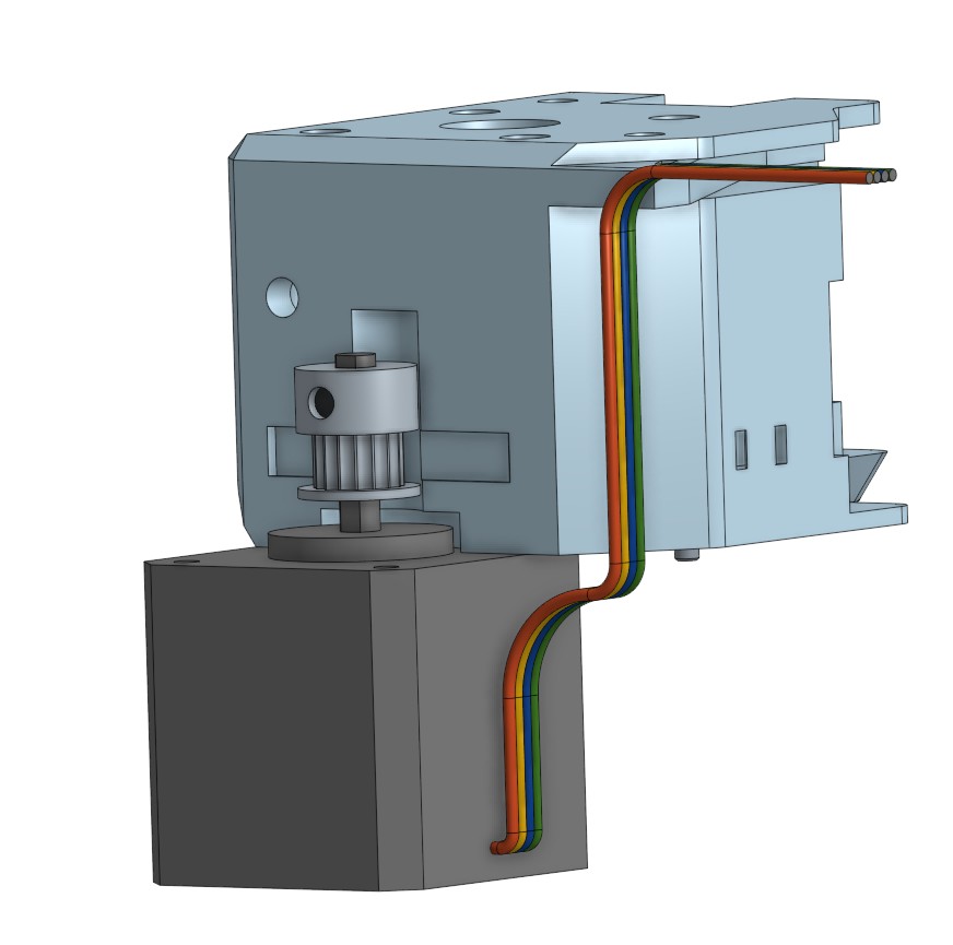

!ZenXY v3 motor 1 assm
  • Use the guide on the back of both MotorMin and MotorMax to align the pulley to the stepper.
  • The pulley can face either direction provided it fits
!ZenXY v3 Motor 2 assm
  • Use the M3 screws to secure the stepper to the printed part.
  • Make sure the wires faces in, they will get secure with cable ties or similar.

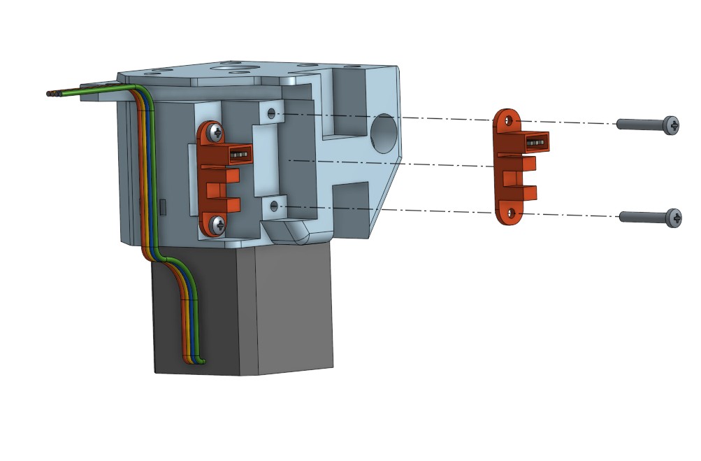

!ZenXY v3 motor 3 assm
  • On the MotorMin assembly add the two endstops with the plugs facing up.
  • Fold the wires and route them in to the wire channel and secure them with the stepper wires.
  • There are wiring pictures later in the wiring instructions section.

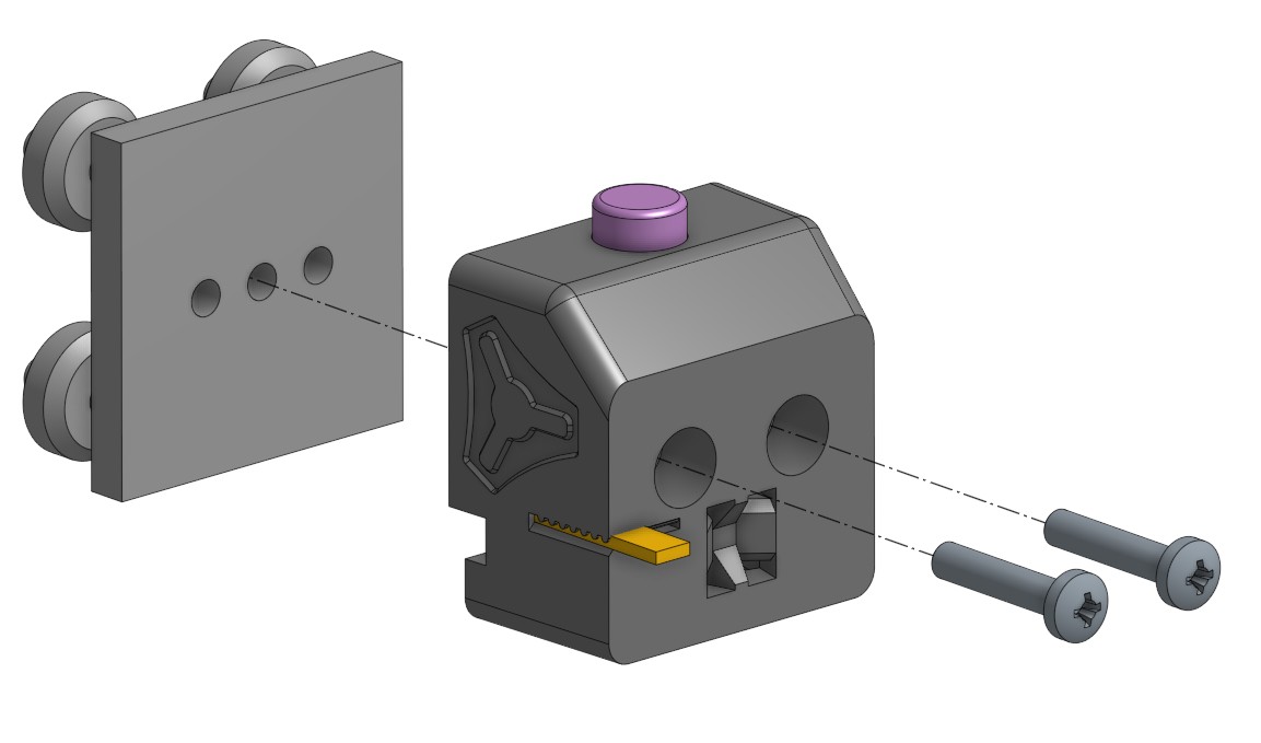

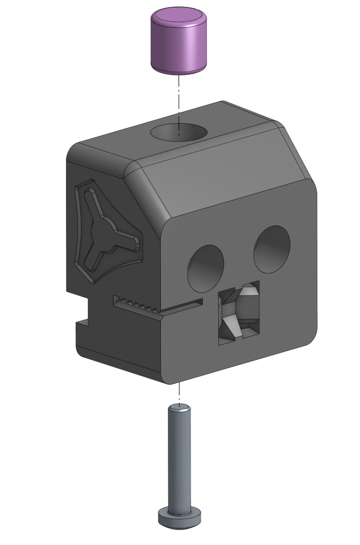

!ZenXY v3 core 1 assm
  • Insert the magnet into the top of the core.
  • Use an M5 to set the magnet gap after assembly. This gap should be as close to the table bottom as possible without touching.
  • The smaller the gap the better the ball sticks and the faster you can move.

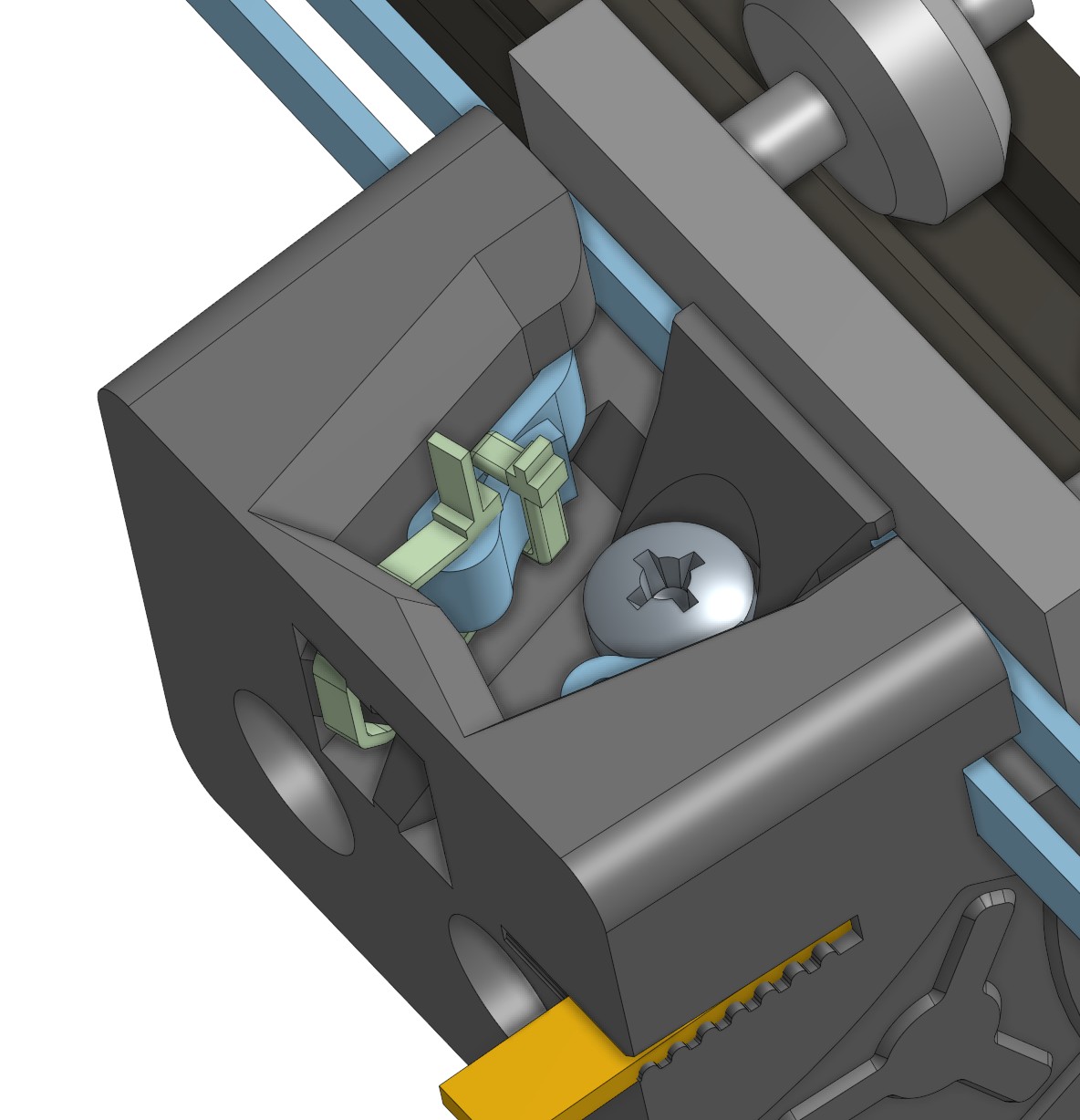

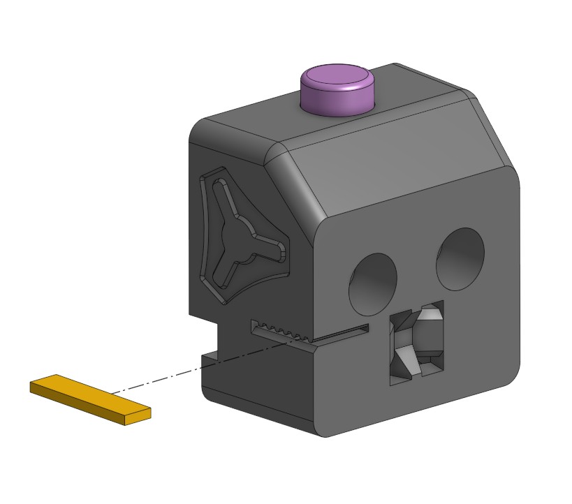

!ZenXY v3 core 2 assm
  • Insert a small piece of the gt2 belt here, 35-40mm (1.5”).
  • Do not push it all the way in, just get the bet into the slot.
  • This X trigger will get trimmed and angled later. This lets you adjust where the X axis stops, after the Y axis triggers.
  • Pushing it further in the slot means the X will trigger further into the corner, the length is dictated by the Y axis.
  • You will be able to see this later with the LED indicators on the endstops.

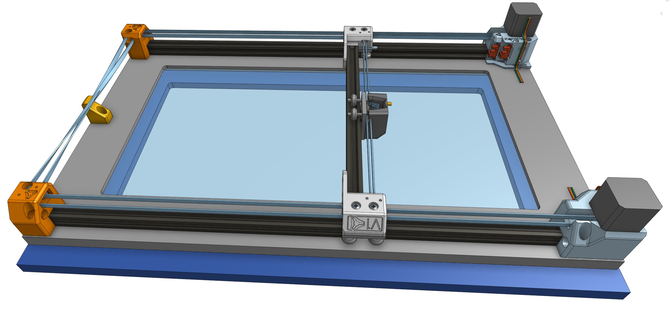

Final Assembly
This section is about adding the minor assemblies to the table itself.
  • You can use the corner parts themselves to mark this out or use the CAD to be more precise.
  • There are sidewall and face mounting screws, chose two per corner, not all are needed.
!ZenXY v3 assm
  • Min side
!ZenXY v3 assm
  • Max Side
!ZenXY v3 assm
  • Center
!ZenXY v3 assm

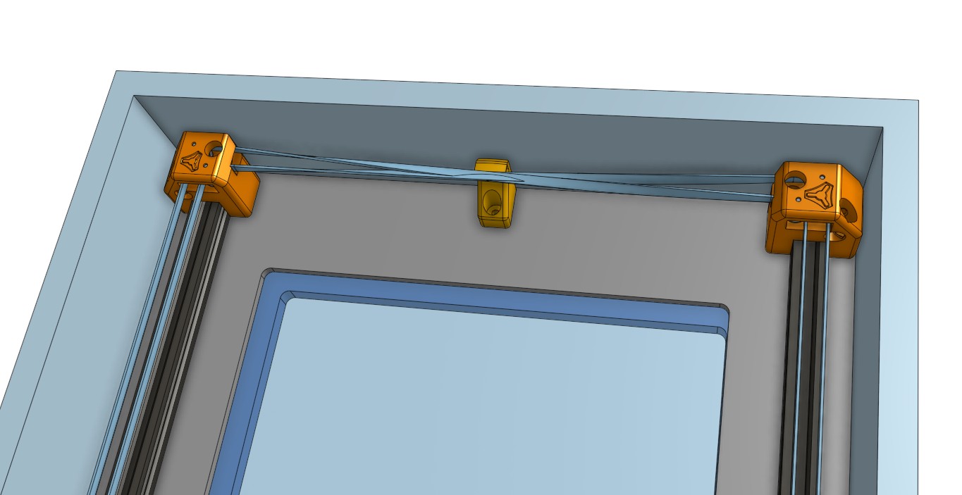

  • Mount the belt silencer directly in the middle of the corners.
  • The belt will get routed around the lip.

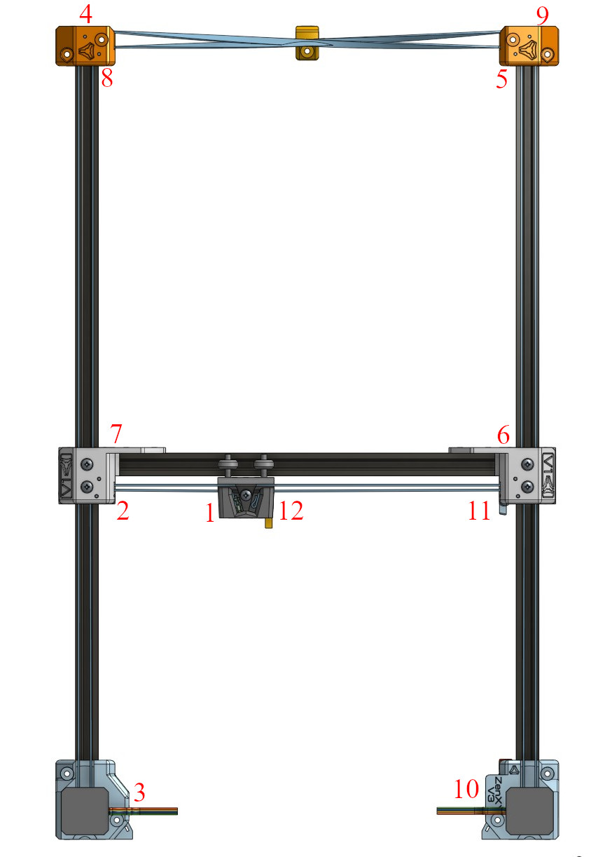

!ZenXY v3 assm
  • Run the belt in the order shown.
  • There is a half twist between 4-5, 8-9.
  • The twist should be made in the same direction on both belts
  • The teeth will face each other.

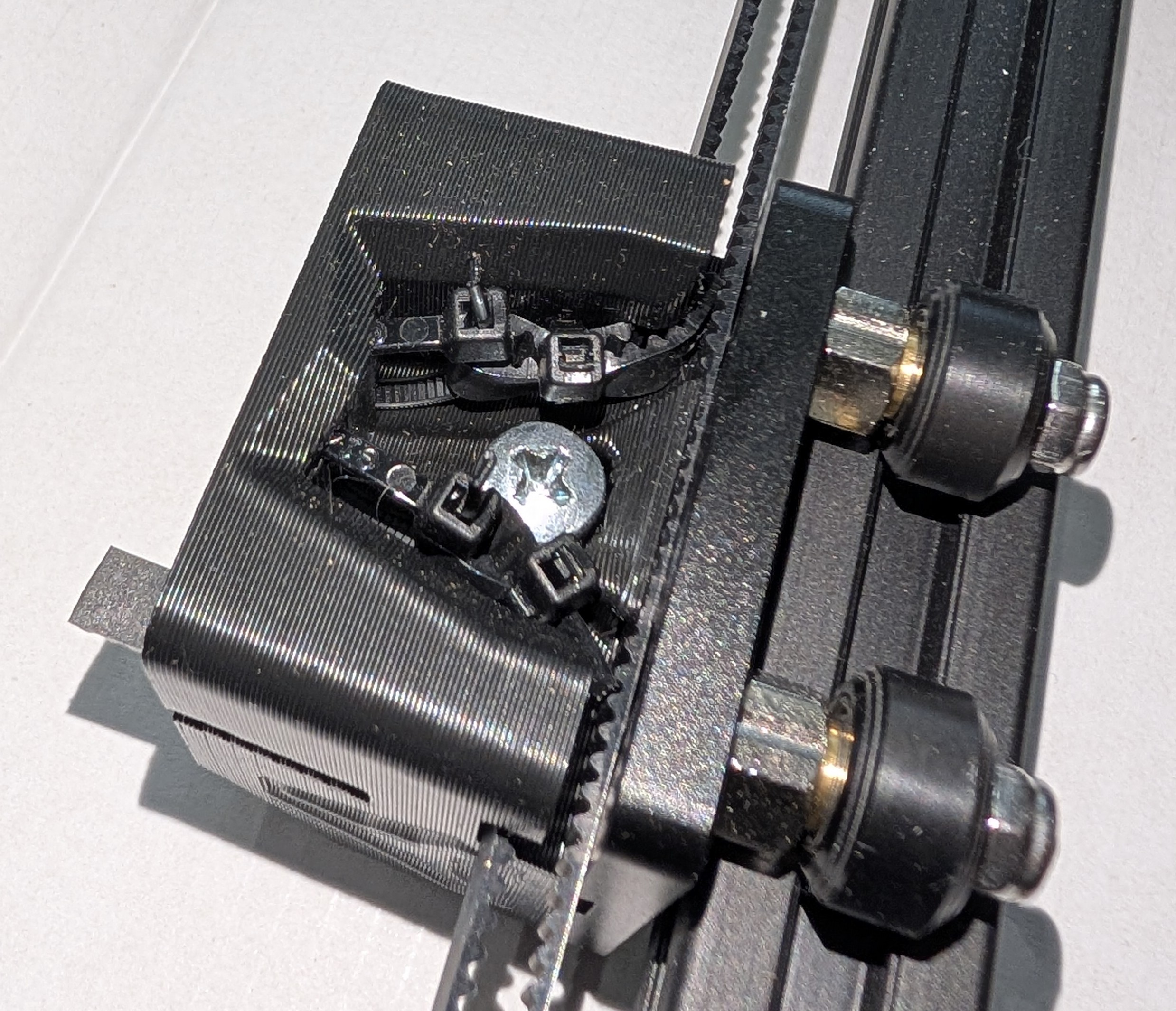

!ZenXY v3 assm
  • This part takes a few tries
  • Get the belt length right, fold it over.
  • You want the loop just past the corner, and just large enough for the tensioner zip tie.
  • lock the belt fold with a small cable tie it works better if it is positioned as shown.
  • Feed in the tensioner cable tie, leave it loose until both are in place.
  • Pro-tip, the belt ends can be removed from the core to get the length right.
!ZenXY v3 assm
  • Here is what it looks like on a real build.
  • The tension ties actually skew the gantry so be gentle.
  • The belt does not need to be very tight at all.
  • Move the gantry all the way to the Y minimum position and the core in the middle.
  • The right tension will have both y blocks touching the corner blocks.
  • Pro tip, if you get this wrong you can loosen the core and move the fixed belt to tweak it the other way.
  • Make sure the belt silencer splits the belt and keeps them from touching each other.
